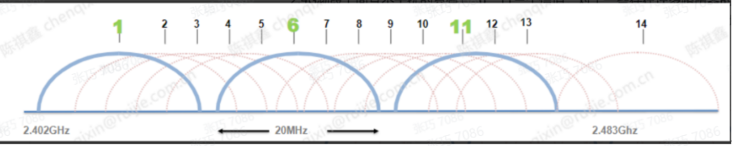

1) Co-channel interference
Co-channel interference exists when two WLAN devices use the same frequency (2.4/5 GHz). As shown in the figure below, the reare three non-overlapping channels 1, 6, and 11 in the 2.4 GHz band. In places with many routers deployed, a channel may be used by multiple routers. Co-channel interference exists in the areas where the signals of these routers overlap.
2) Adjacent-channel interference
As shown in the figure below, channels 1–5 overlap each other. Therefore, interference may exist in the areas where the signals of two routers overlap even if the routers do not use the same channel.
