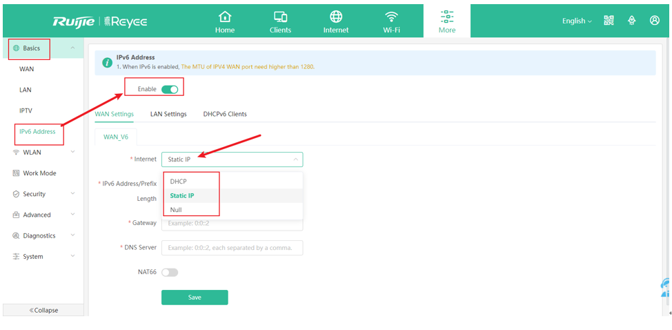

Internet Connection Type:
If you select DHCP, and the device will get an IPv6 address from the upstream device.
If you select Static IP, please configure the IPv6 address, gateway address and DNS server address manually.
If you select NULL, the IPv6 address function will be disabled on the WAN port

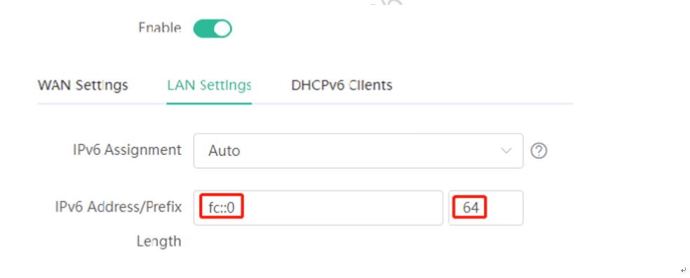

Click LAN Setting:

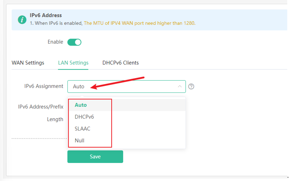

IPv6 Assignment: Choose Auto to use both DHCPv6 mode and SLAAC mode to allocate address. Choose
Null to assign no address. You are advised to choose Auto.
IPv6 Address/Prefix Length: If the router fails to obtain an IPv6 prefix, you can configure one manually. Set
the subnet prefix length to a value smaller than or equal to 64.

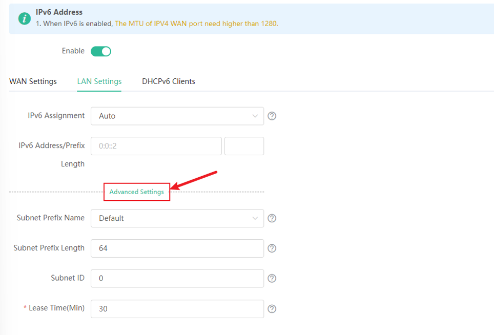

Click Advanced Settings to perform the advanced settings. See the following figure for the recommended configuration.

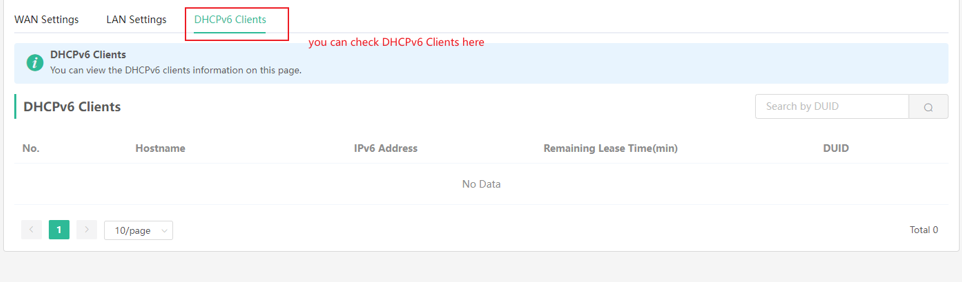

Click DHCPv6 Clients to view the list of clients that have obtained IPv6 addresses from the router.
