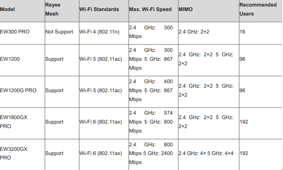

Note: Ensure that the device in normal use supports the mesh function
Model support mesh function:

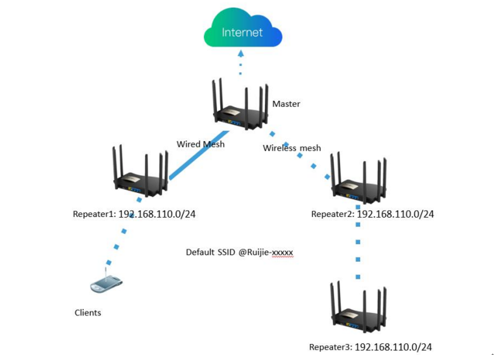

2.Topology:
Note: Recommend upgrading the device to the latest version of the firmware

1. Make sure Master gets the DHCP IP address from ISPto access the internet, broadcasts default SSID @Ruijie-mxxxx which is used byclients and broadcasts default hidden mesh Wi-Fi to let repeaters connect.
2. Repeater connected with Master using wired or wireless will broadcast the default SSID @Ruijie-mxxx after mesh succeeds.

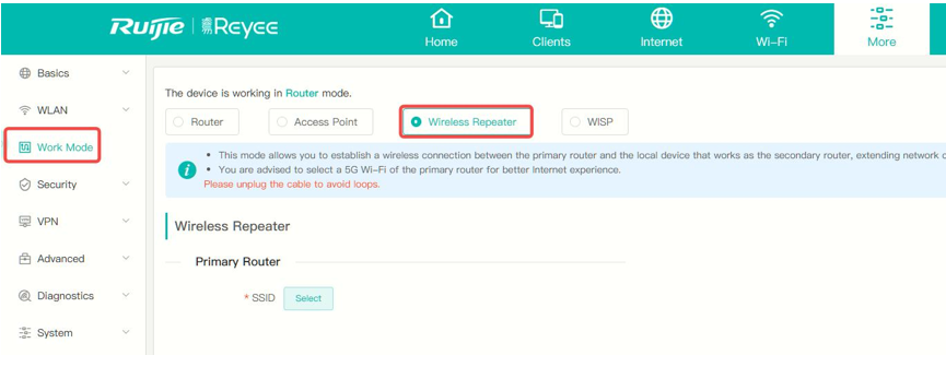

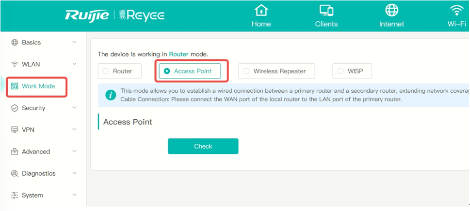

3. Checkthe current Work Mode of the shave device.
Wire connection:
Wireless connection:

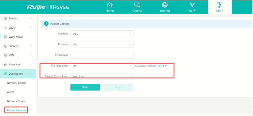

5. If the previous steps do not detect the cause of the mesh formation failure, you can try to capture the packet from the device
