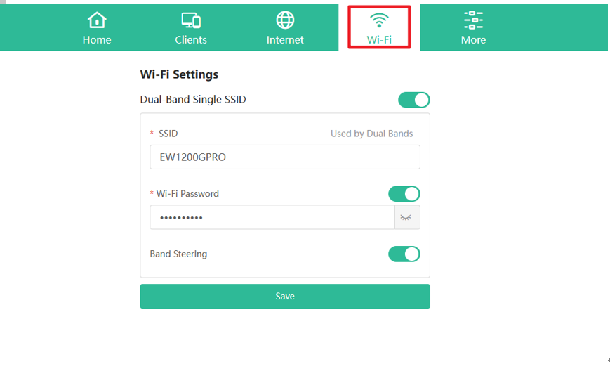

1) Check whether the SSID can be searched, if it fails, check the primary router status and test if other devices can search the SSID of the primary router.

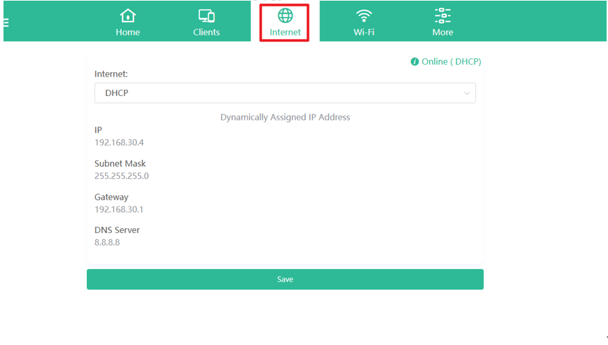

2) If the primary EW's SSID can be searched. Check whether the EW router can get an IP address via DHCP successfully. If it fails, please check the DHCP configuration on DHCP server and test if other devices connecting to the same SSID can get IP successfully.

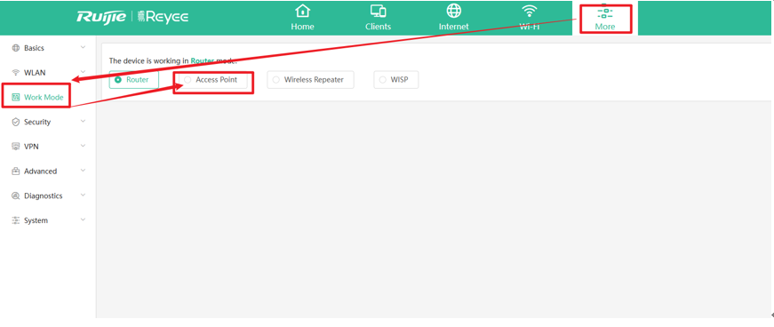

4)Connect the LAN port of the primary router to the WAN port of the secondary router, and configure it to Access point, after it has bridged successfully, disconnect the network cable and switch as wireless repeater.

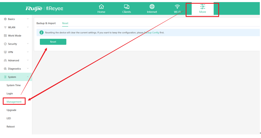

5) Restore factory setting and bridge once again
