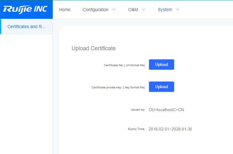

I just upgraded the switch version RG-S5760C-24GT8XS-X to the latest version and found an expired license
I am currently asking the impact of expired license to ruijie's R&D team
has anyone experienced this before?
Thank you

Dear Kamalul,
As confirmed with R&D, this certificate is the public key used for encryption. The certificate can still be used for encryption even after it expires, i.e. expiry will not affect the performance of the certificate, it will only be a reminder for you to update the key. You may also upload your own certificate on this interface for enhanced security.
