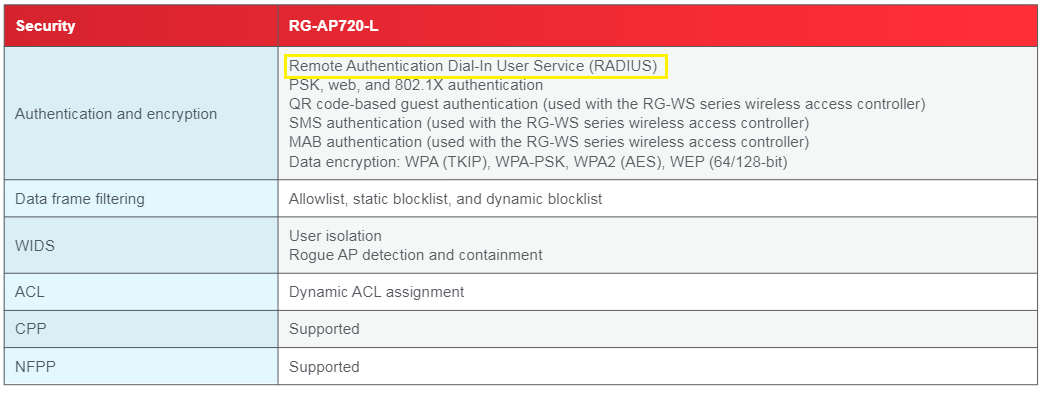

Hi, according to datasheet of RG-AP720-L, you don't need to use AC to deploy RADIUS on this device, the features that need AC are specified in parenthesis:
Regards.
