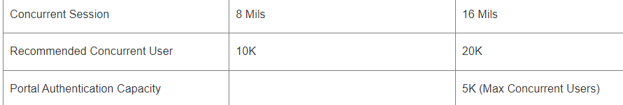

Hello,
I checked the specifications of the RG-EG3250, and it states that the maximum capacity of concurrent users in the captive portal is 1500. I have configured the router with the "1-click login" option. Once the user authenticates on the portal and starts browsing, do they stop being a concurrent user of the portal and become a regular user of the network?
On the other hand, what would be the maximum limit of active devices that the router supports on the network?
Waiting for your reply,
Kind Regards
Salvador
RG-EG3250
Router Specification Authentication
0 2023-6-8 09:54:57 View all replies
Once the users are authenticated, they will be counted as the authentication users, not regular users.
There is not a parameter for the maximum number, only the recommended number is available.
0 2023-6-8 15:11:09 View all replies
GTAC-Patrick replied at 2023-6-8 09:54
Once the users are authenticated, they will be counted as the authentication users, not regular user ...
Thanks.
I expect around 10000 maximum users on the network, most of them through captive portal.
Should I switch to the [strong]RG-EG3000XE?[/strong]
Waiting for your advice,
Kind regards
Salvador
0 2023-6-8 15:33:59 View all replies
CTO Nexo replied at 2023-6-8 15:11
Thanks.
yes.
