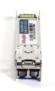

Hello,
does the SFP port on the RG-AP680(CD) capable of run at 10Gbps (SFP+)?
I want to connect it with this module on the AP and another one onto a 10Gbps port of a RG-S6120-20XS4VS2QXS:
<colgroup><col></colgroup>XG-SFP-LR-SM1310
Waiting for confirmation.
Thanks in advance
Salvador
RG-AP680(CD)
Wireless Network Setting Specification Wi-Fi 6
0 2023-6-9 20:29:49 View all replies
Dear sir,
Unfortunately it can not support that
coz AP680(CD) can not support SFP module XG-SFP-LR-SM1310

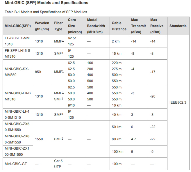

So could you tell me the compatible SFP (not plus) 1Gbps transceiver model that works with the AP, please?
0 2023-6-12 11:59:52 View all replies
CTO Nexo replied at 2023-6-10 01:45
Thanks.
So could you tell me the compatible SFP (not plus) 1Gbps transceiver model that works with ...
Dear sir,
Here are the  transceiver model that can works with the AP
Ross
