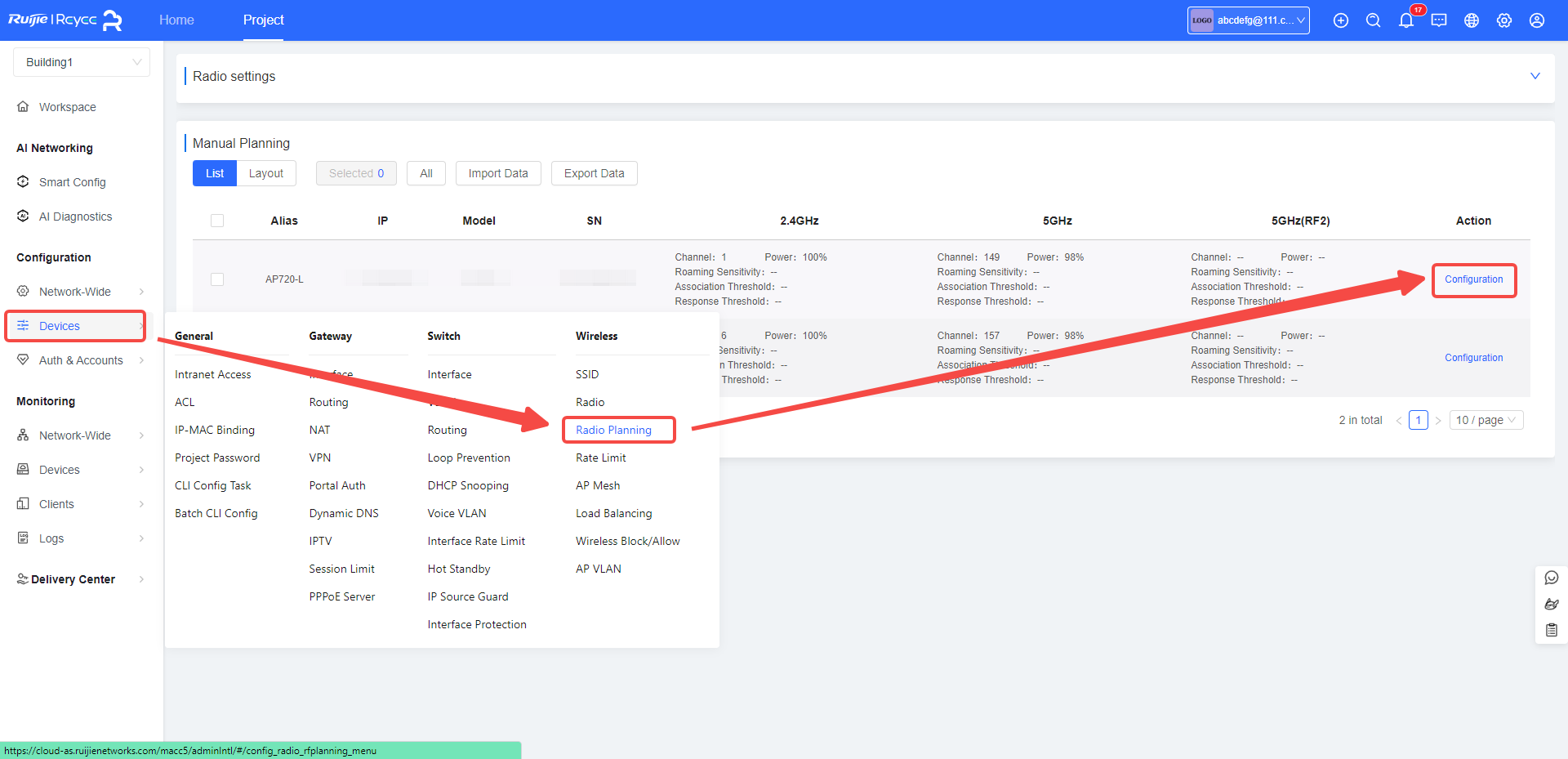

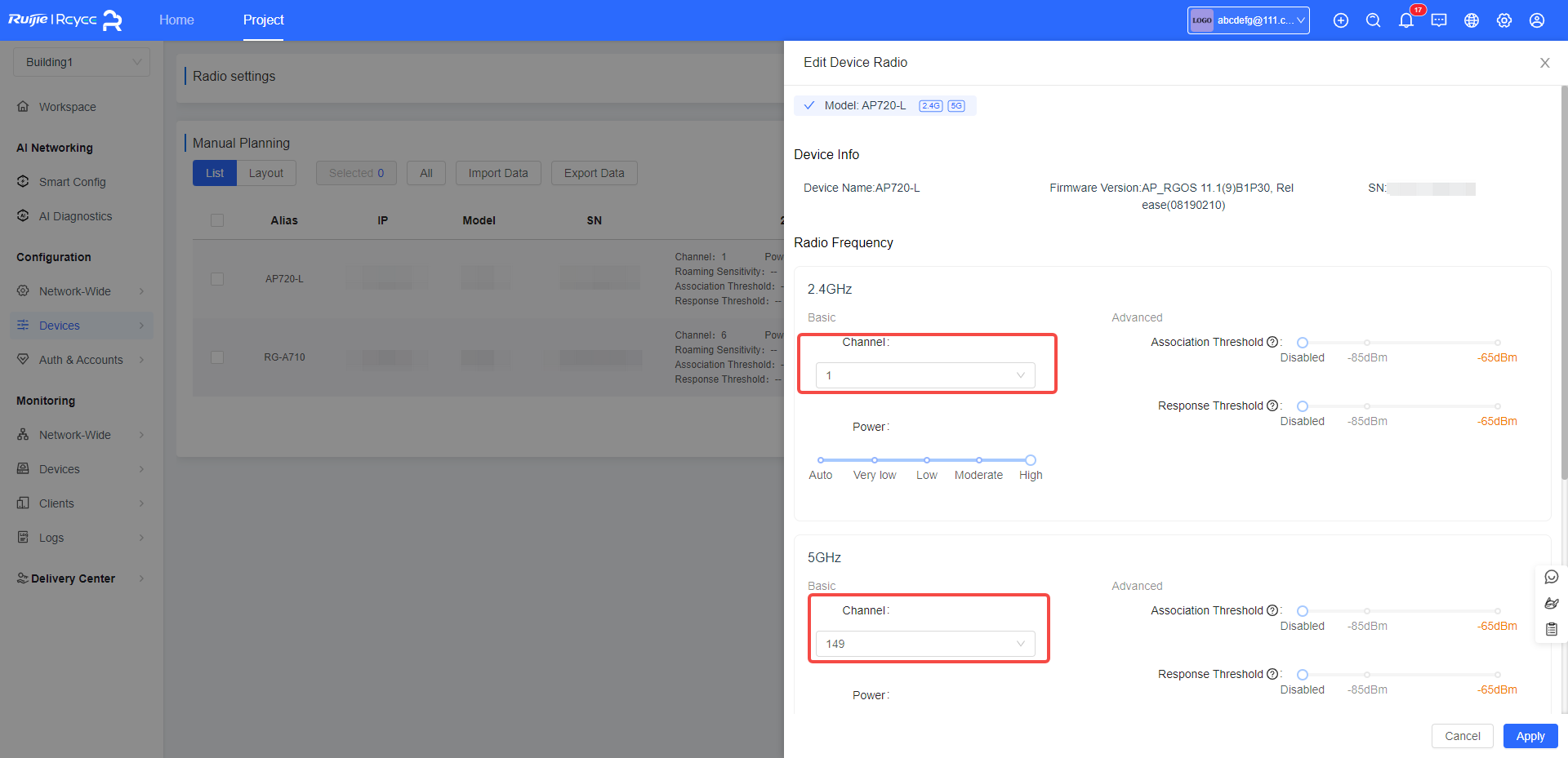

Dear sir,
You can manually change the AP channel as in the following pictures:
Jayden
