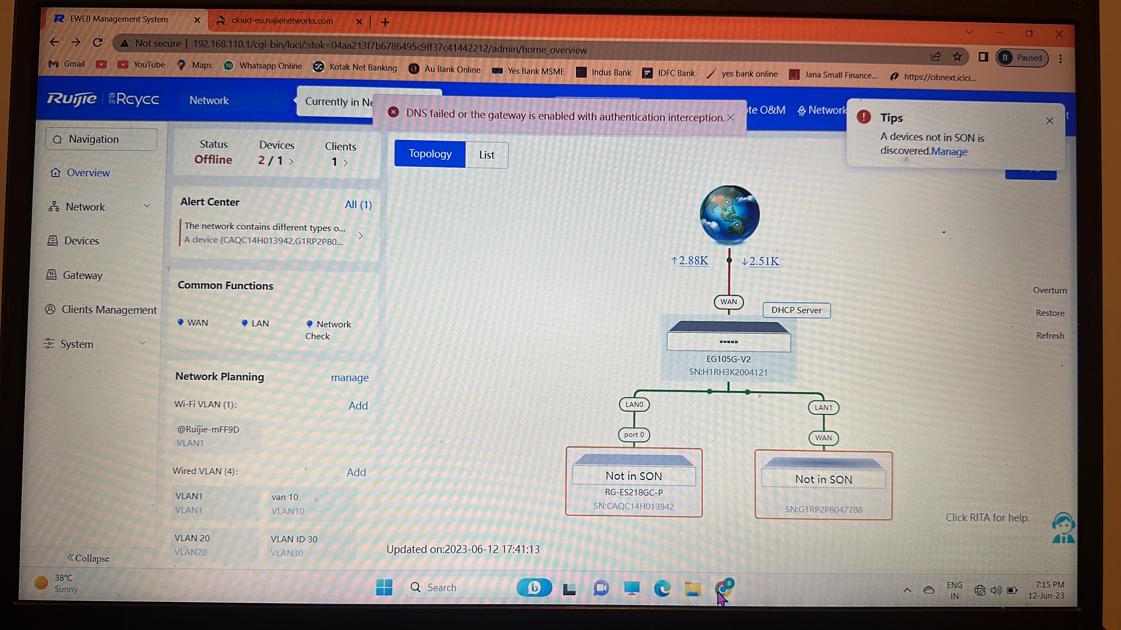

when i connect my main enternet cable to my ruijie e10g v2 router after i go to the 192.168.110.1 the router is says dns failed authentication error show and router not show online pls help to conf... Reply

router is not connected to the dns server

Can provide the following information
1Device version
2 Acquisition of the WAN port address of the device
3.DNS configuration of the device
4ping google.com results
5network check results
0 2023-6-14 04:23:01 View all replies

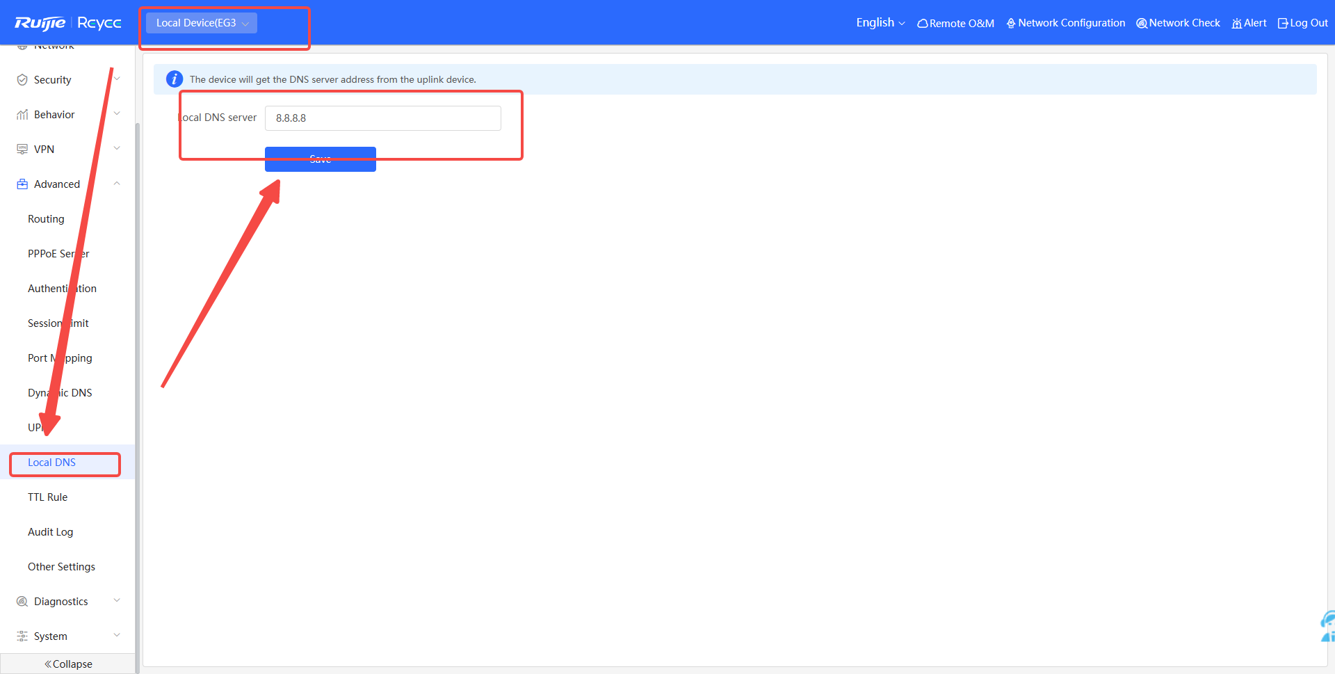

Can you try change the DNS server of the device and obsever for a while ?
