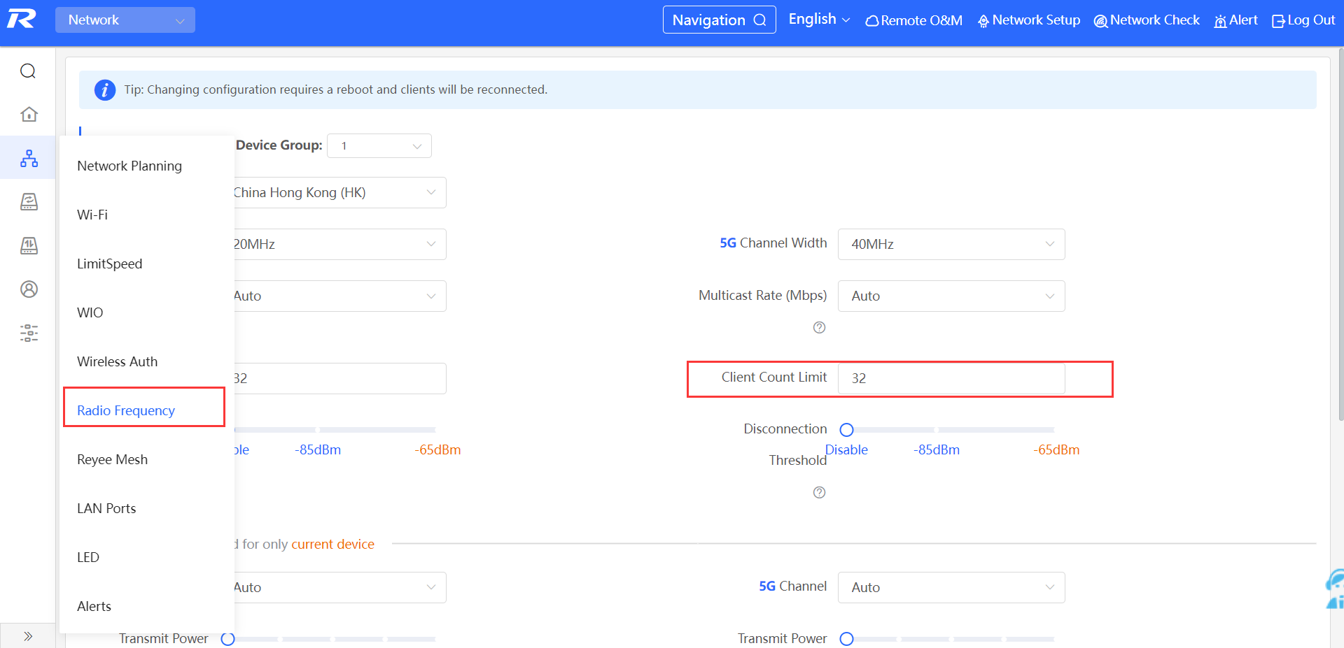

I check the recommended client of RAP2200(E) is 80(16(2.4G)+64(5G)). So it is not recommended the connected user exceed this value. And you can check the STA limit config here.
