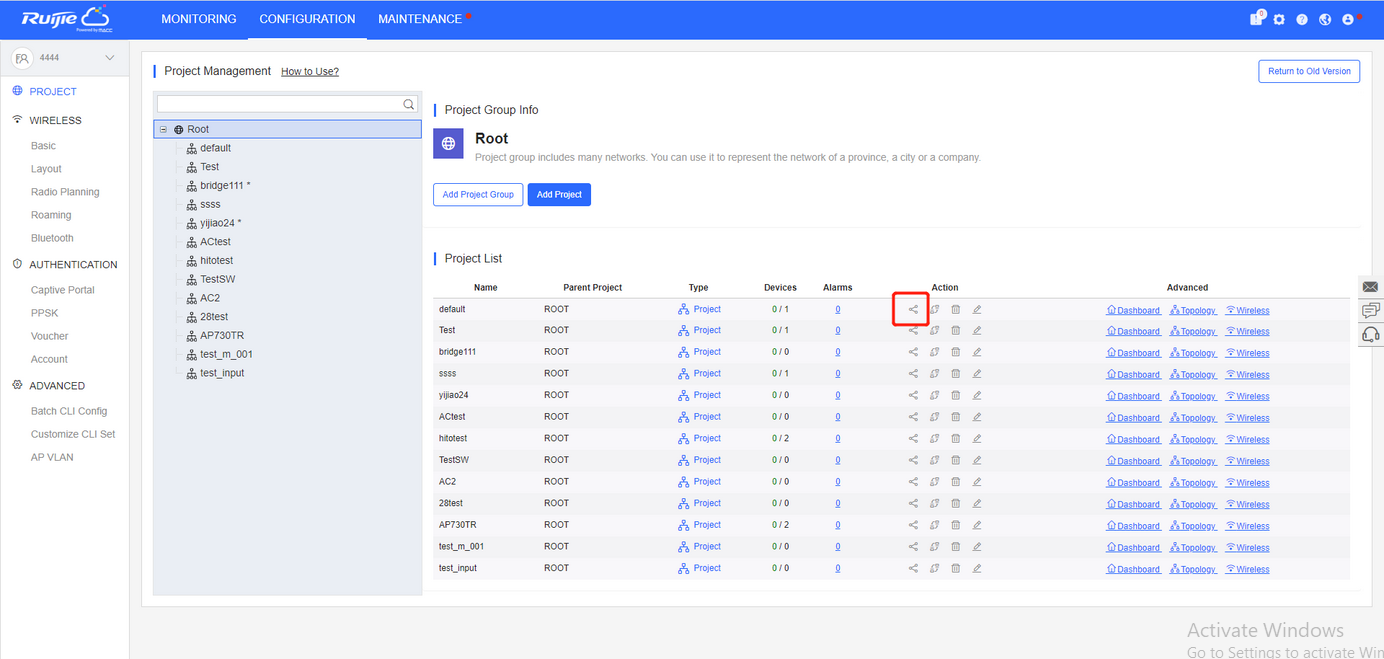

Will all terminal can not the 5G SSID? Can you show me the radio configuration ?  if the device is online on Cloud , can you share network to me ? if can ,please send the sharing link to this email service_rj@ruijienetworks.com

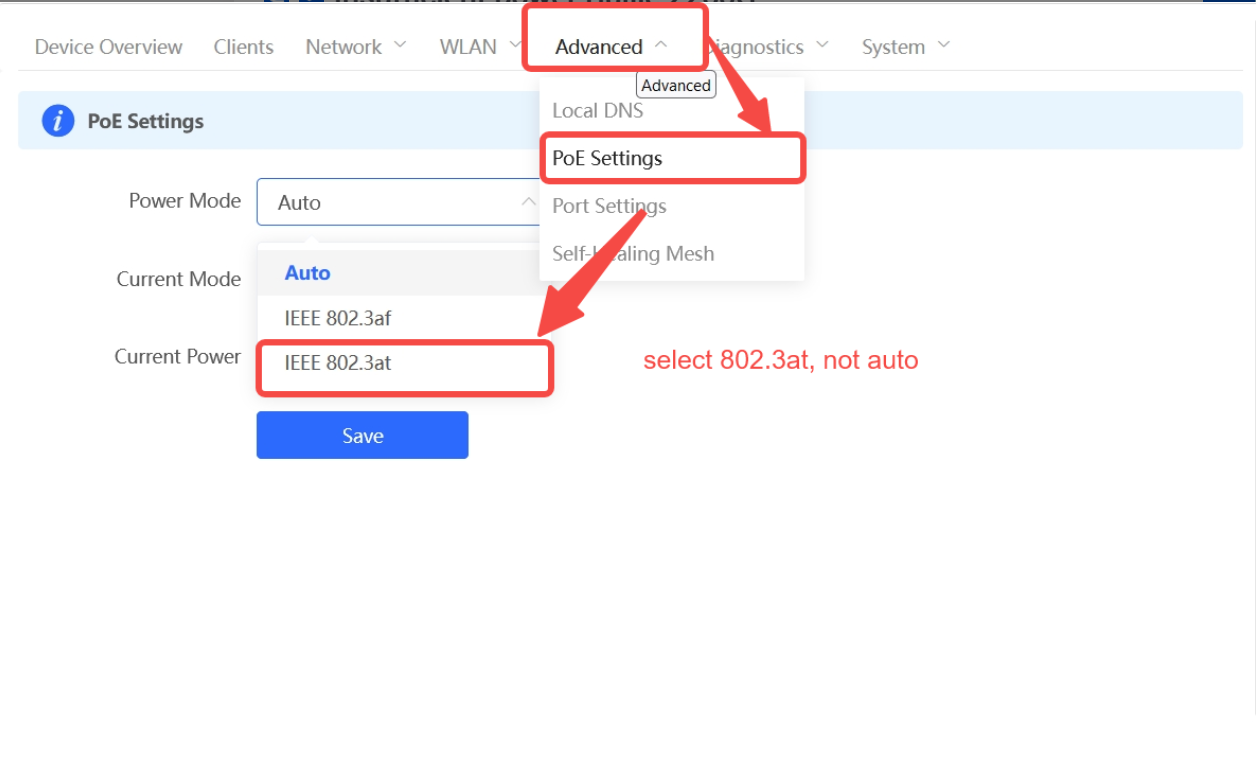

Link cloud was sent to your email sir. I get a notification about power insufficient. I used rg-poe-50-60w-mg for 2260.

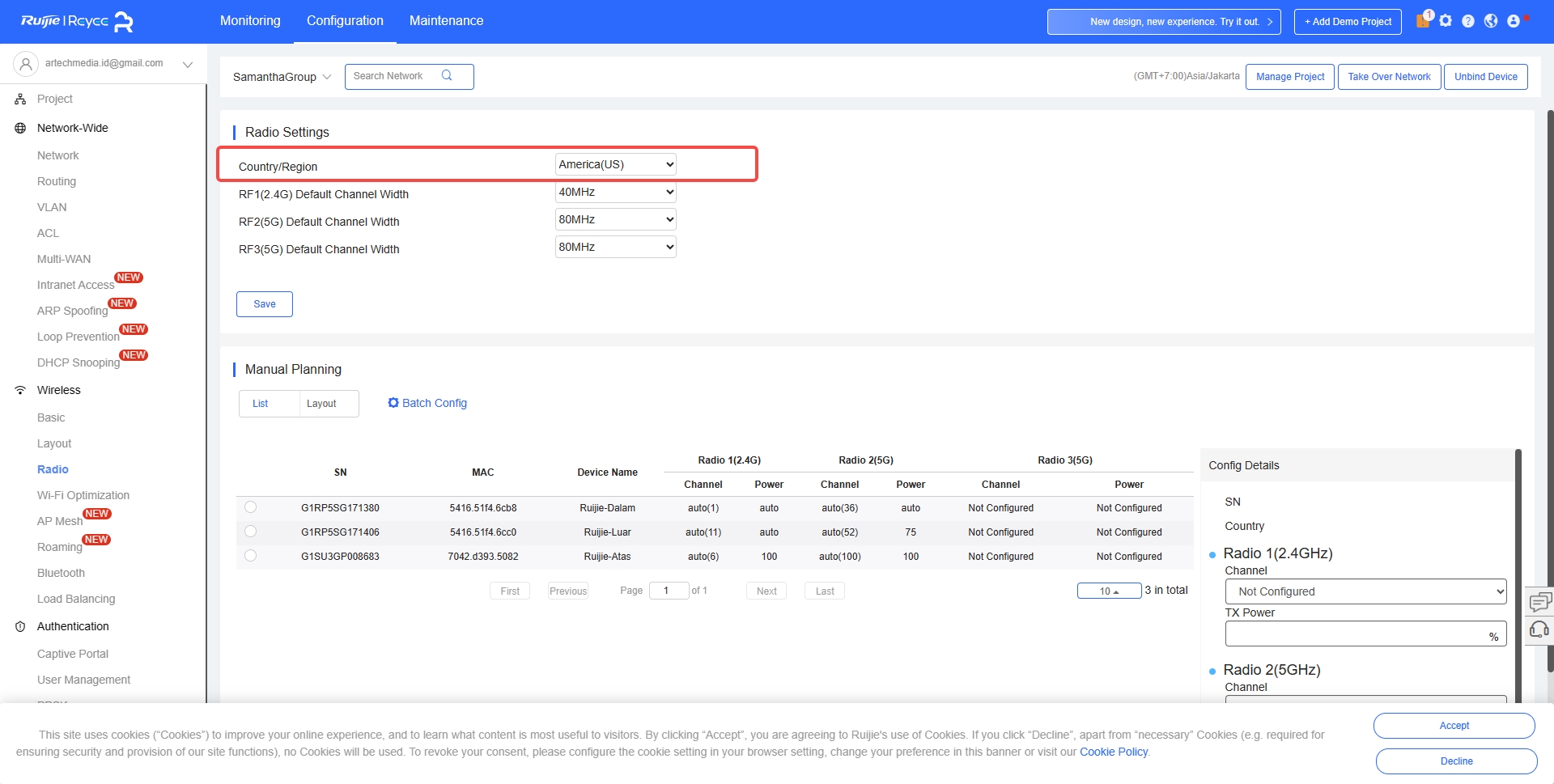

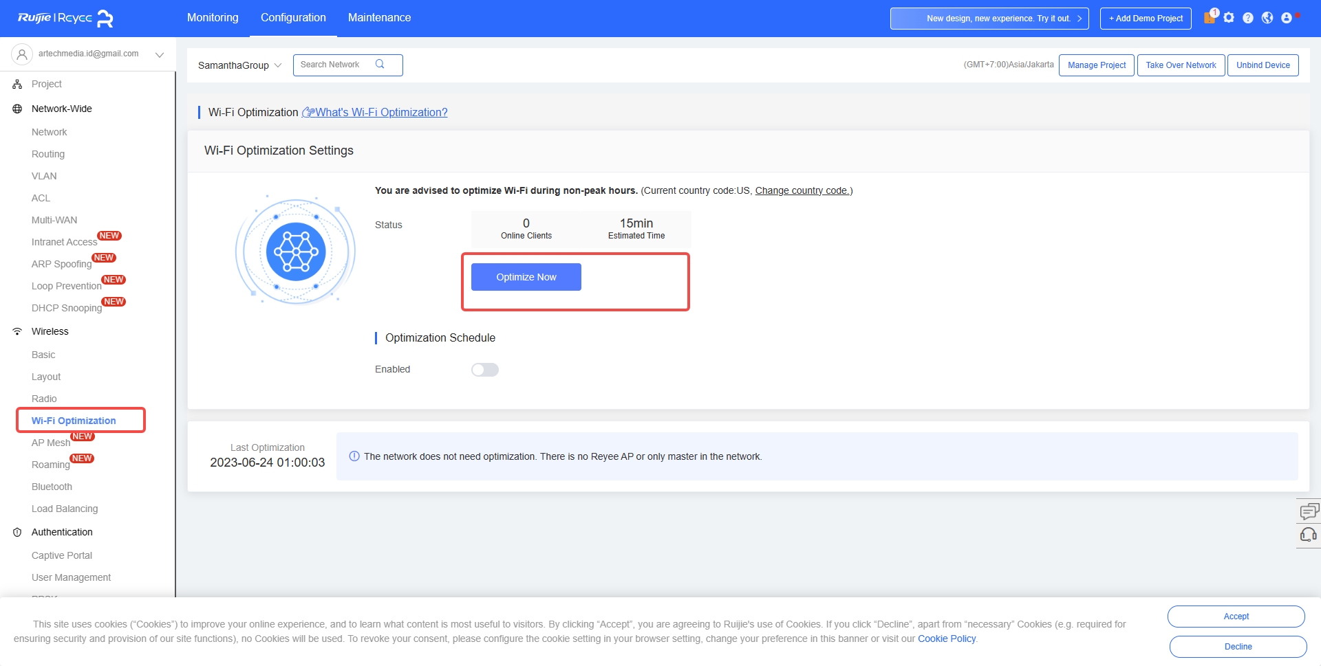

Can you try change the country code to Indonesia and run wifi-optimization then test again?

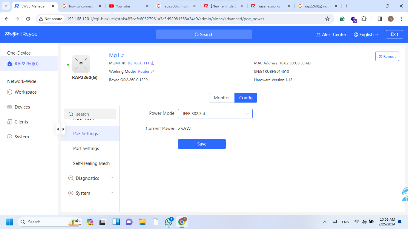

Hi:
If you can not see the 5G network, you can also check and change  the PoE protocol manually on your AP:
If this can not work, we recommend you to start a live chat session to troubleshoot this issue on real time.

Hello.
Replying here too.
I made the suggested change and it worked! The 5Ghz is working.
Thanks!!!
Now, it's quite strange that it doesn't work correctly with the AUTO option.
I have 45 AP to configure and I'm going to have to do it one by one. >.<

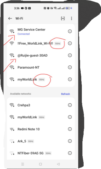

same problem not connected to 5ghz
0 2024-2-23 20:32:40 View all replies

Hi sir,
Could you pelase check the power supply mode of the AP?
Steve

Hi sir,
done bt not solved my problem same only connected at 2.4 even mobile device is 5g

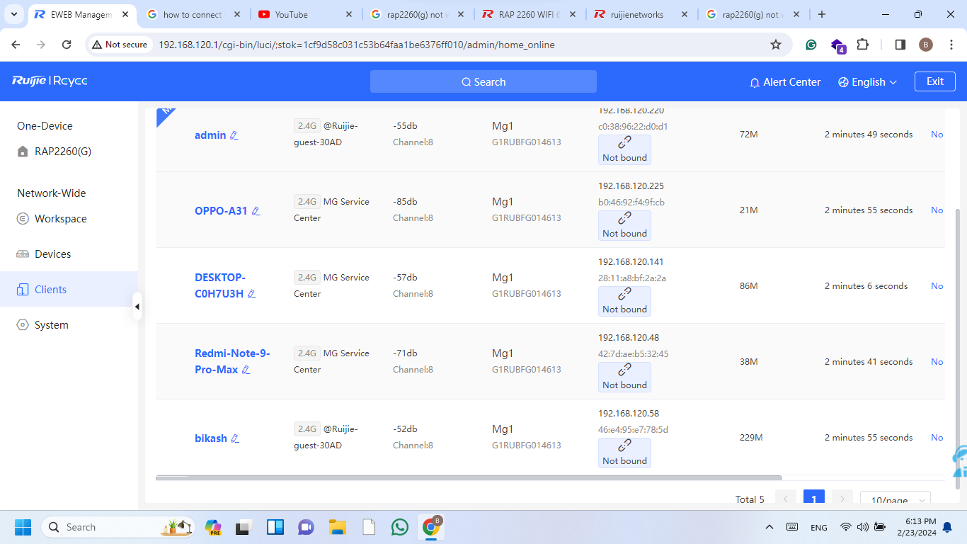

May I know whether the mobile phone can search the 5G wifi signal successfully? Can you share with me your network to further check this issue?

bikashshre09@gmail.com invites you to manage the project "%Mg office%". Please copy the message and open the Ruijie Reyee App to receive the project. Code: @CEC6A3CA563F4C8695642DE6C7578650@193406# [Invitor: #bikashshre09@gmail.com#]]

May I know whether all the terminal devices can not be able to search the 5G wifi signal? Whether the 5G wifi can be searched normally before? I have changed the RAP 5G channel to another channel 100 and create a test5g open ssid, please help check again whether it is still the same issue?

no there is not showing test 5g ssid and also you can see all devices are connected to 2.4 only

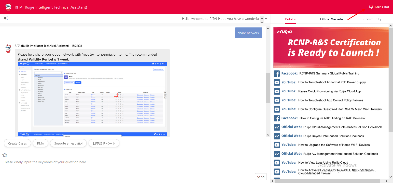

May I know whether both APs have the same issue? You can with us on Rita Live(https://www.ruijienetworks.com/rita ) for this problem to solve your issue quicker.

ok thankyou ill connect you tomorrow today's office hour is finished
