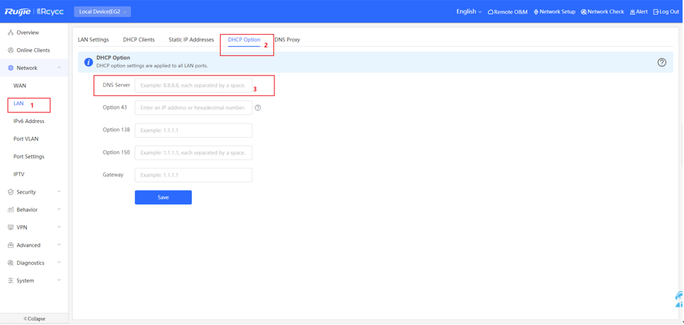

Click LAN Settings -DHCP Option
You can configure the DNS server. The Option field is optional. Configure the DNS server in the format prompted and save the configuration.
Note: The DHCP configuration is shared by all LAN interfaces. After the modification, all LAN interfaces and LAN sub-interfaces take effect simultaneously.
RG-EG105G-P
Configuration Router

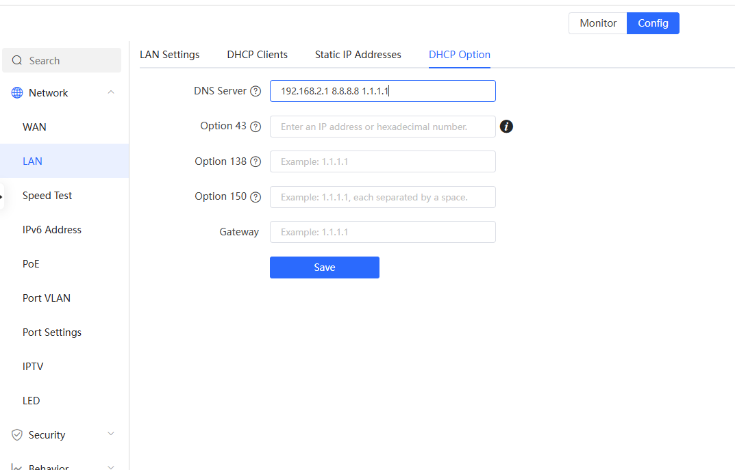

Hello Support
How do I add 2nd DNS Server, do I need to use ; or , ?
Kind Regards

Hello Jacques,
You write the second DNS just next to the first one, no character is needed.
Regards!

Example
192.168.2.1 8.8.8.8  Like this?

Hi Rossouw,
That is correct. The addresses of the DNS servers are separated by a space.
