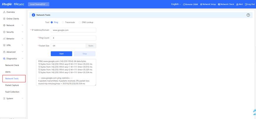

Choose Local Device > Diagnostics> Network Tools.
Select a Tool, enter an IP address or URL, and click Start. The ping method is used to test the connectivity between the tested device and the specified IP address or URL. If ping fails, the device is not connected to the IP address or URL. The traceroute method is used to trace network paths to the specified IP address or URL. The DNS method is used to check the DNS server address for URL parsing.
