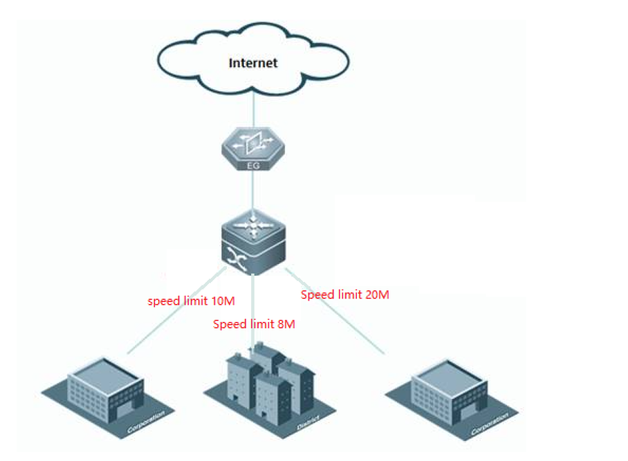

2. Networking requirements:
All branches of an organization connect to the cores witch through MSTP lines and share the unified network egress. Because branches have different scales, the administrator wants to set the uplink and download rates for the ports connected to each branch.
3. Networking topology:
3. Configuration Points:
