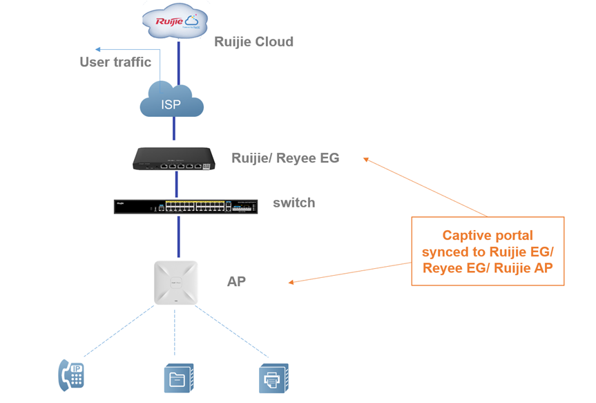

Topology

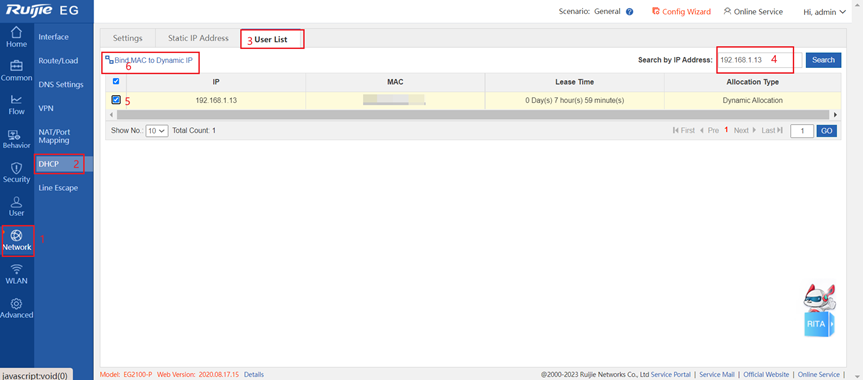

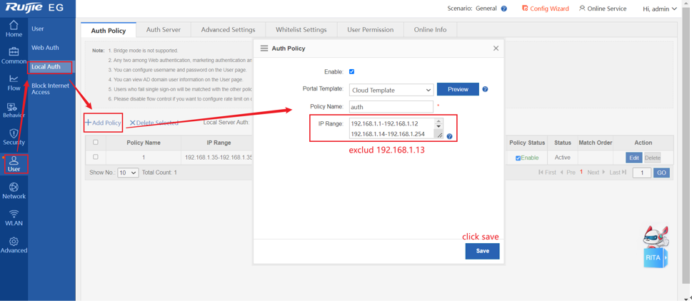

Ruijie EG
EG as DHCP serves for Intranet users, you can statically bind the IP addresses of these users or devices to the EG. For example 192.168.1.13 as a printer ip address.
When configuring the auth IP range of the captive portal, exclude that IP address.

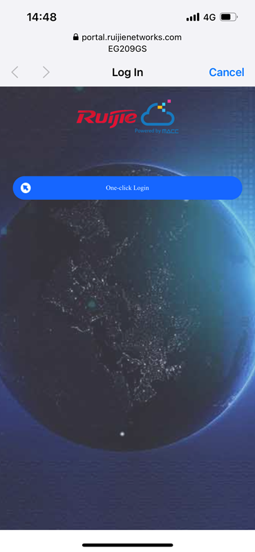

Testing with mobile phones so that we can see the result:
Before enabling the whitelist of this user, it will pop up the authentication page and users need to click it to login then access the internet:

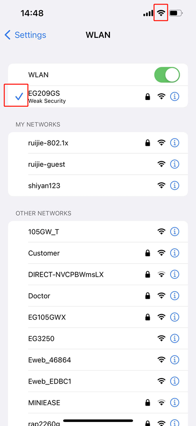

<span style=""">After enabling the whitelist of this user and trying to access the internet again, it can connect to SSID and access internet directly:
