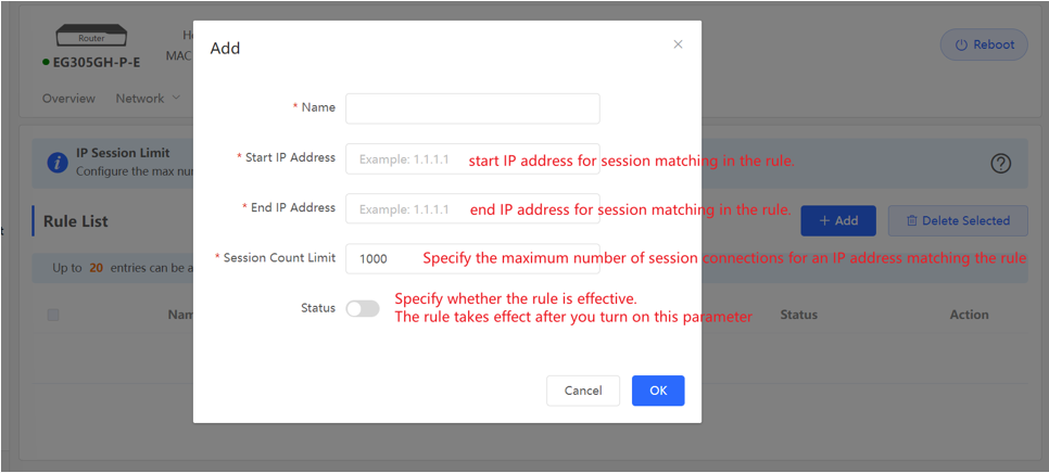

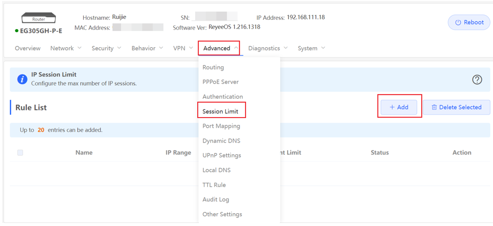

This function is used to control the maximum number of connections per IP address.
RG-EG105G V2
Configuration Router
