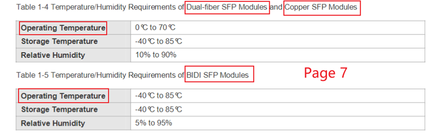

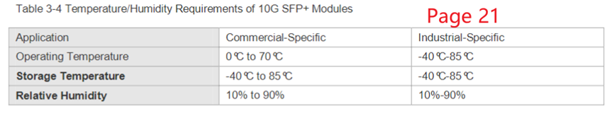

You can check this document about the parameters ofour Ruijie SFP modules.
Ruijie Transceiver Installation and Reference Guide, V3.0 - Ruijie Networks
For Operating Temperature, you can check the 3tables according to the type of SFP modules.
