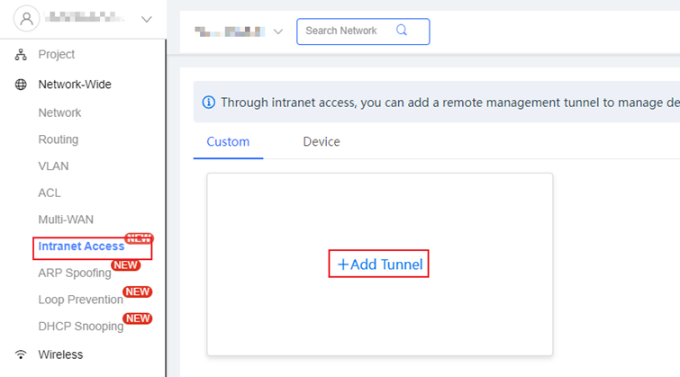

Next, you can enter the Intranet Access page on Ruijie Cloud, click Add Tunnel

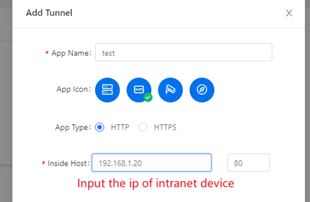

Input the IP address of your intranet device, likeNVR or camera.
Please check if the port number of the intranetdevice is also open and active.
Please make sure the network connectivity between the intranet device and the tunnel device is normal.

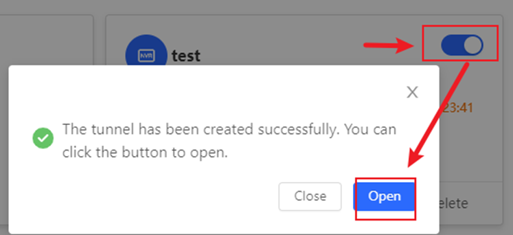

Click on the active button, then you can try to open this tunnel.
