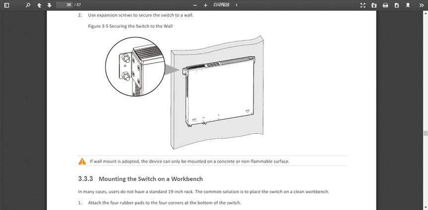

Does the RG-S2915-10GT2MS-P-L support wall mounting? Reply
3444 0 2023-6-27 11:41:56
RG-S2915-10GT2MS-P-L can support wall installation, you can install the device on the wall according to page 36 of this link.
Ruijie RG-S2915-L Series Switches Hardware Installation and Reference Guide (V1.1) - Ruijie Networks
