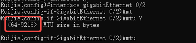

You can modify the MTU according to the followingcommand
S5310E(config)#int g0/1
S5310E(config-if-GigabitEthernet 0/1)#mtu 1500
The range of MTU configuration is 64-9216

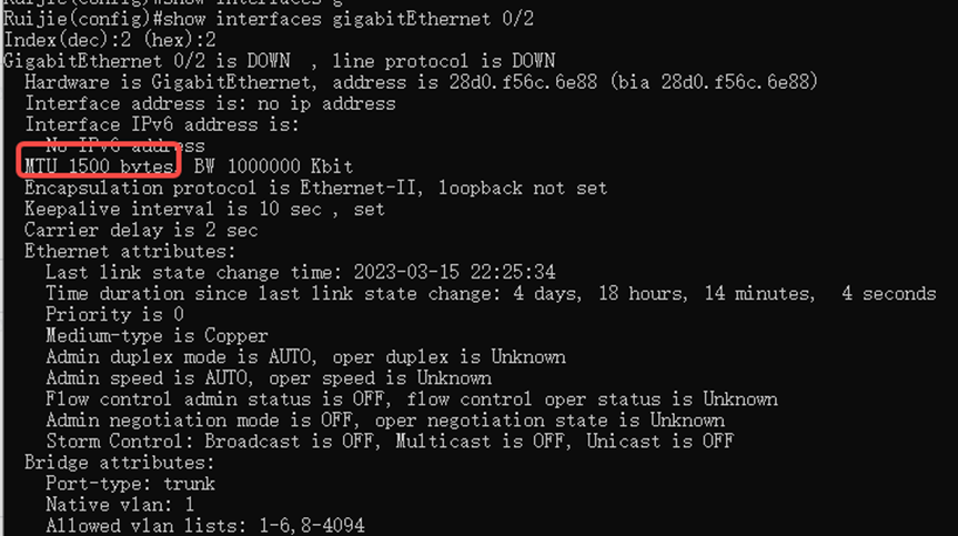

You can check the current value of MTU through this command
Ruijie#show interface gigabitEthernet 0/2
