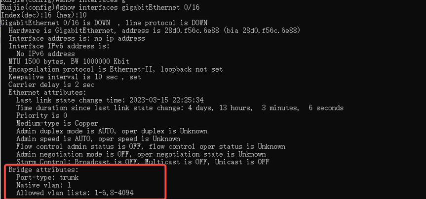

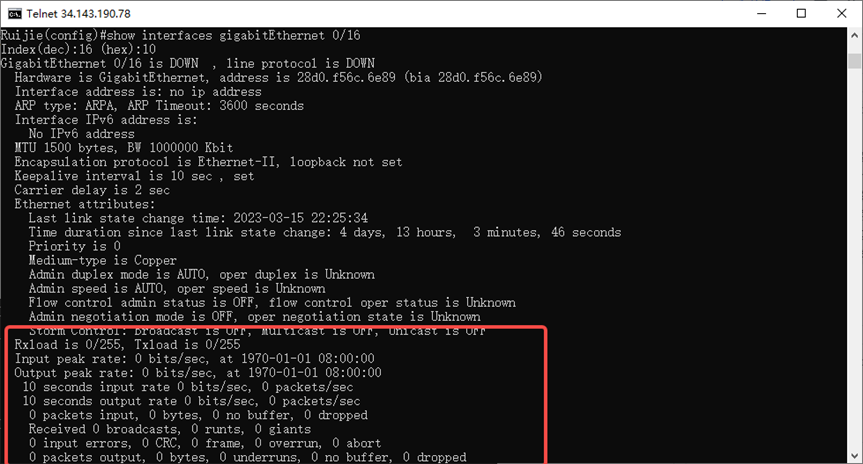

After you have switched, you can check the switchstatus with the following commands:
Ruijie(config)#show interfaces gigabitEthernet 0/16
Layer 2 interface
Layer 3 interface
