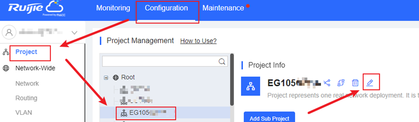

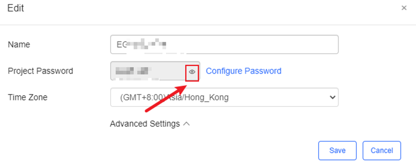

If the device is online on Ruijie Cloud, you can check and set the management password of your network project. This password will be synced to the Reyee devices in the same SON network.

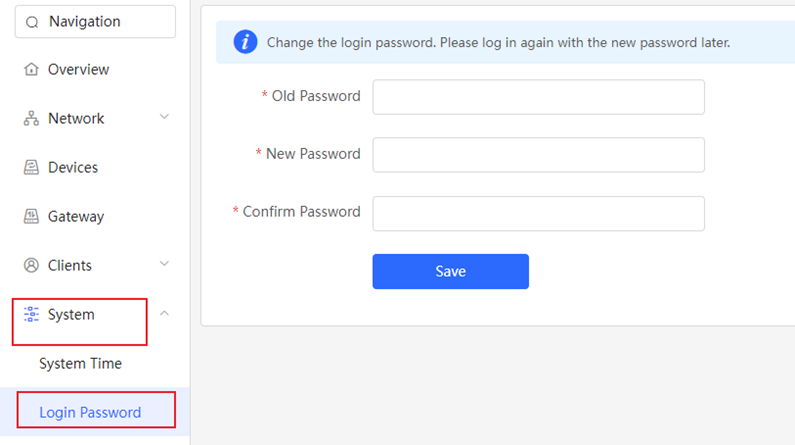

If you can login to Reyee EG locally, you can set the management password on this menu of eWeb:
[System] > [Login Password] > Change the login password
This password will also be synchronized to the Reyee devices in the same SON network.
