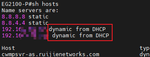

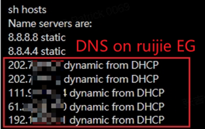

When Ruijie EG's uplink ISP modem has additional DNS configured, Ruijie EG will learn that DNS and provide it to the user who is connected. As shown in the figure:

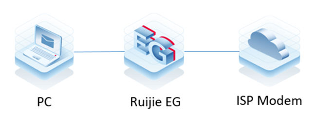

1.Topology& Phenomena:

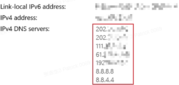

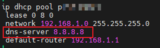

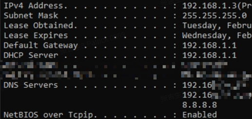

As you can see, a PC connected to Ruijie EG will not only get the DNS from DHCP pool, but also ISP modem.

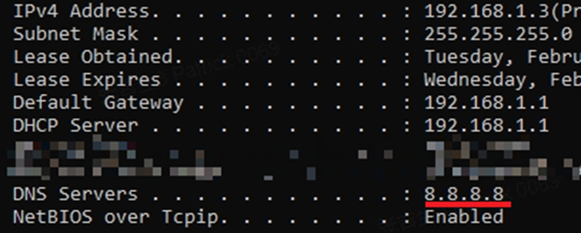

2.2 Turn off the network adapter of the PC, thenturn it on again.
3.Test Result:
Check the network adapter of PC via this command: ipconfig /all
