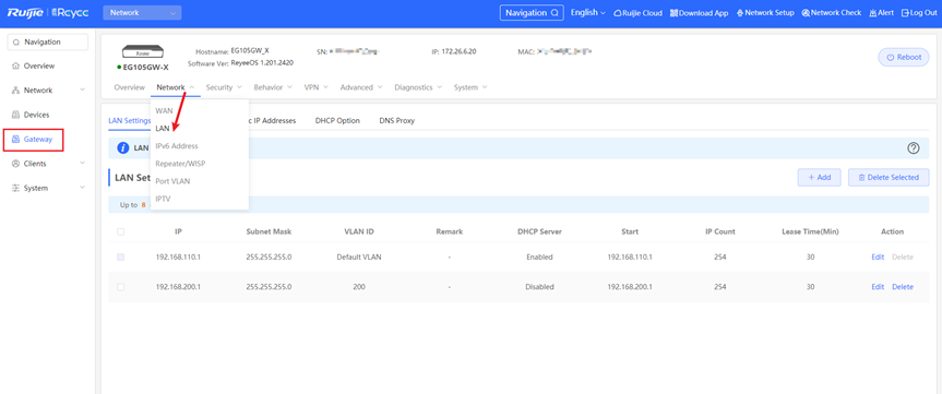

1. Click Gateway - Network - LAN

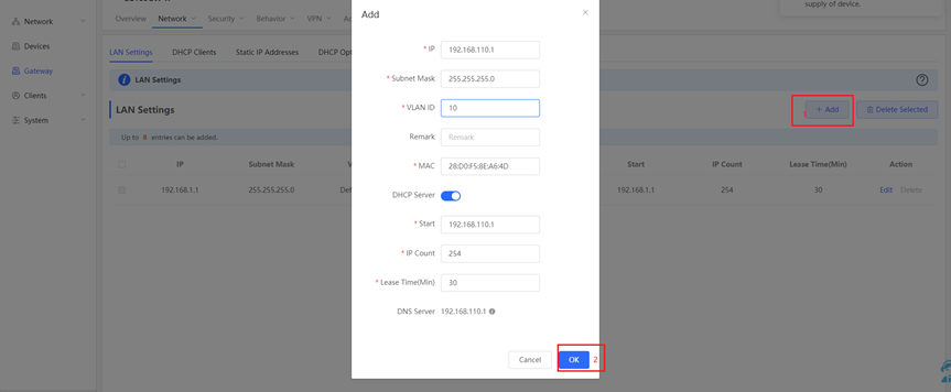

2. Click Add. For example, set the IP address of the sub interface to 192.168.110.1, subnet mask to 255.255.255.0, VLAN ID to 10, and enable the DHCP service.

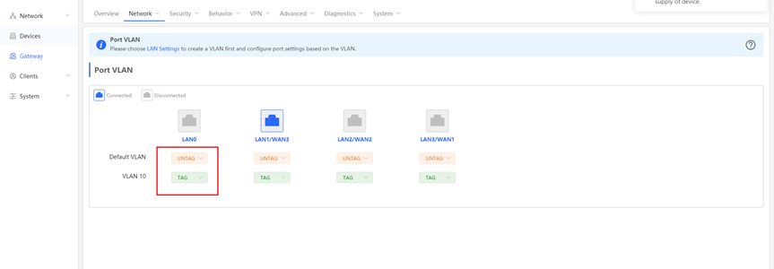

3. Set port VLAN: Click Gateway - Network - Port VLAN.
The default VLAN of port 0 is untagged, and theVLAN10 whose addresses need to be delivered are tagged. The configuration is shown in the following figure.
