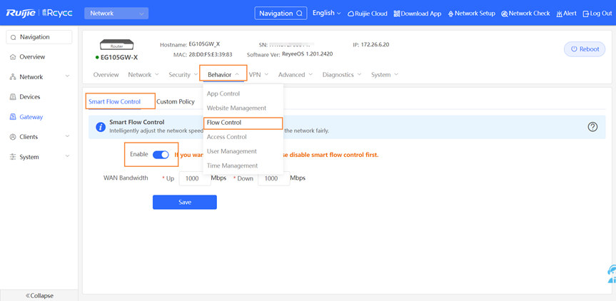

Step1: Choose Local Device> Behavior> Flow Control> Smart Flow Control. Turn on Enable on the Smart Flow Control tab and set the line
bandwidth based on the bandwidth actually allocated by the ISP. Click Save to make the configuration take effect.
If smart flow control is disabled, the flow control package for the account does not take effect. Before you configure a flow control package, enable smart flow control first.

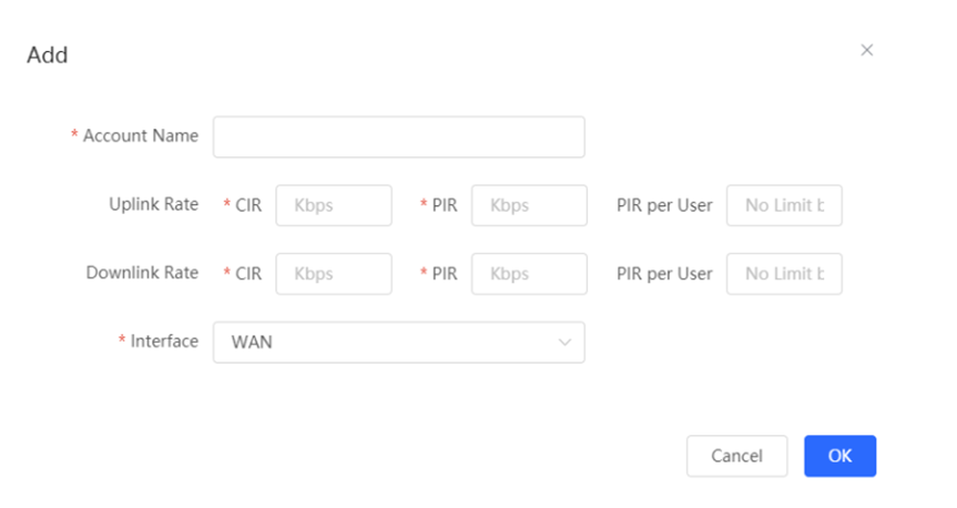

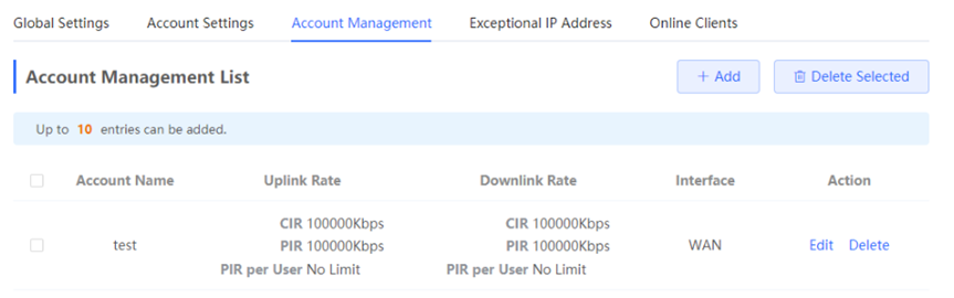

Step2: Choose Local Device> Advanced> PPPoE Server> Account Management,click Add to create a flow control package.
The currently created flow control packages are displayed in the Account Management List section. You can modify or delete the packages.
Account Name: Set the name of the flow control package. When you configure an authentication account, you can select a flow control package based on the name.
Uplink/Downlink CIR: Specify the committed information rate (CIR) for the authentication account when the bandwidth is insufficient.
Uplink/Downlink PIR: Specify the peak information rate (PIR) that can be used by the authentication account when the bandwidth is sufficient.
Uplink/Downlink PIR per User: Specify the PIR that can be consumed by each user. This parameter is optional. By default, the PIR per user is not limited.
Interface: Specify the interface to which the flow control package applies.
