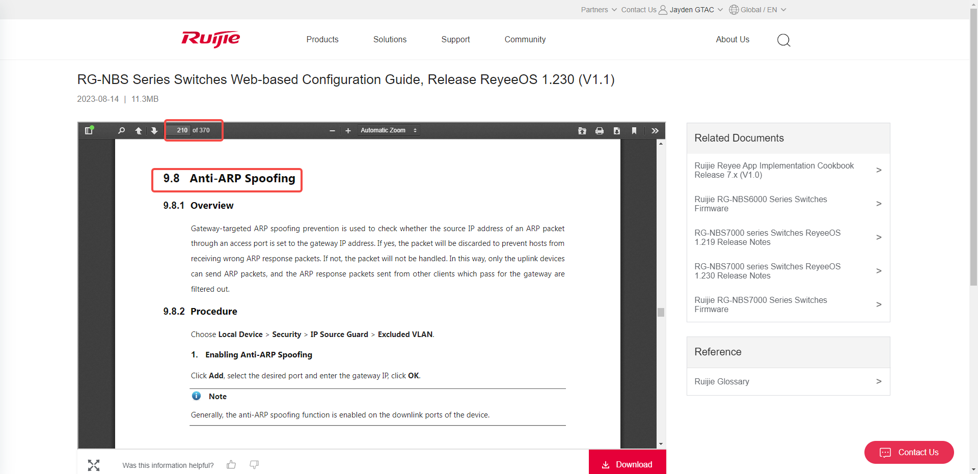

How? I didn't understand that. Why isn't there any transaction from the interface menu?
0 2023-9-28 19:23:01 View all replies
Özgür Öztürk replied at 2023-9-28 19:11
Dear Özgür Öztürk,
Please kindly note the static ARP configuration in the original post is for Ruijie enterprise switches only.
If you want to configure anti-arp spoofing on NBS series switches, please kindly refer to the web-based configuration as follows:
https://www.ruijienetworks.com/resources/preview/rg-nbs-series-switches-web-based-configuration-guide-1-230
