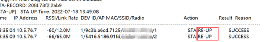

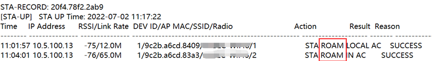

You can enter this command into AC to check roamingmode:
AC#show wlan diag sta sta-mac xxxx.xxxx.xxxx
1.re-up Layer 2 Roaming:
2.roam Layer 2 Roaming:
Note: By default, layer-2roaming of AC is not displayed as roam, and roaming entries are not created. The roaming table can be enabled by running "roaming layer2with-entry" command. This function is not required except in some special cases.
