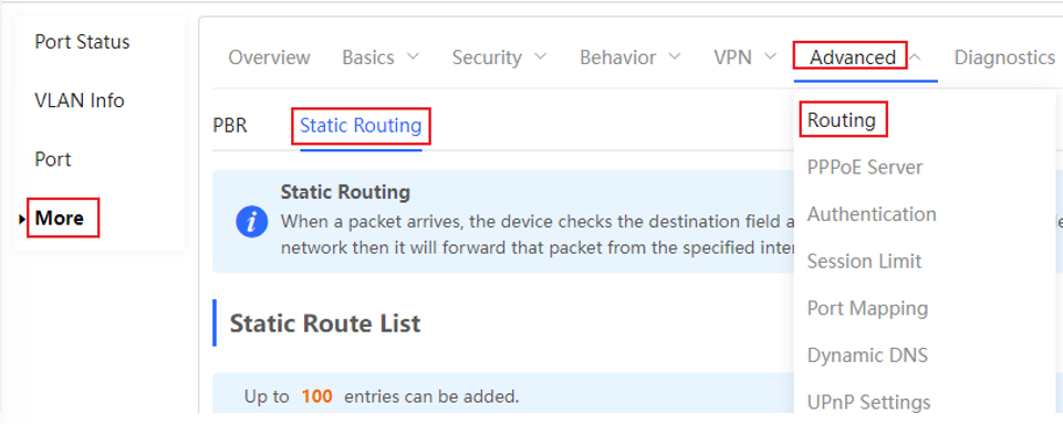

1.Login to the eweb of Reyee EG, enter to thispage:
[More]> [Advanced] > [Routing] > [Static Routing]

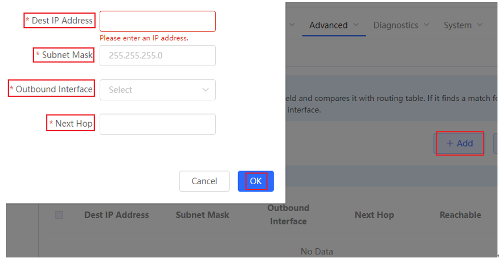

2. Click on the Add button, input the parameters, then click OK.

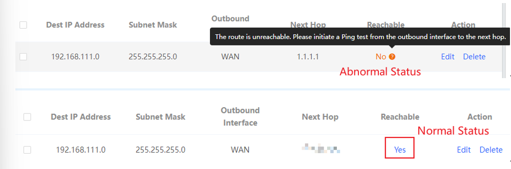

3.When you have done it, you can check the Reachable parameter which specifies whether the next hop is reachable, based on which you can determine whether the route takes effect.
