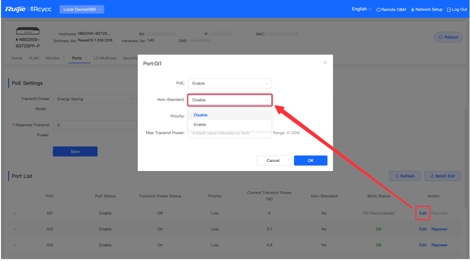

By default, the device only supplies power to PDs that comply with the standard IEEE 802.3af or 802.3at protocols. In practical applications, there may be PDs that do not conform to these standards. After the non-standard mode is enabled, the device port can supply power to some non-standard PD devices.

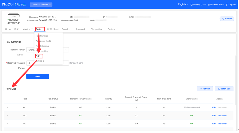

1. Goto Local Device > Ports > PoE > Port List.
2. Click Edit in the port entry or click Batch Edit to set the PoE power supply function of the port.
