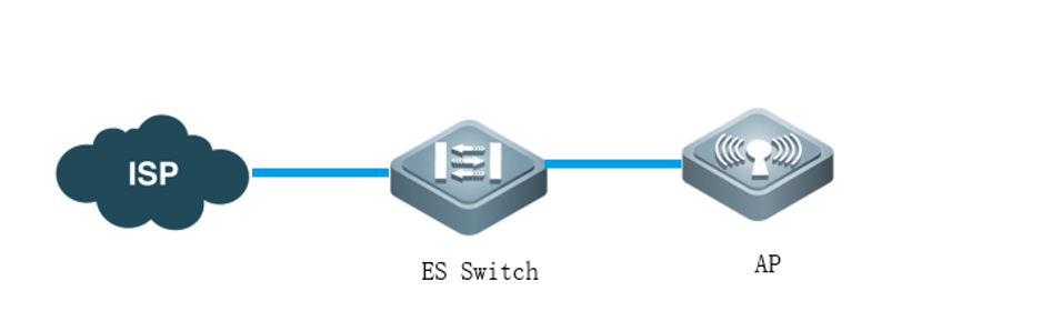

1. Network Topology:

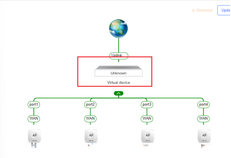

You can see that the unknown device is displayed in the cloud topology and is offline.

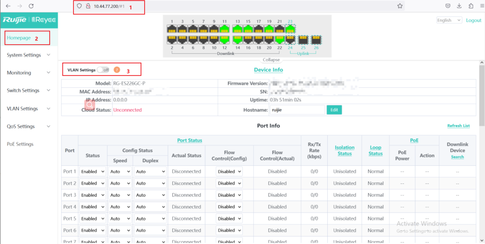

2. Troubleshooting procedure:
Log in to the web UI of the switch using the default switch address 10.44.77.200 and check whether the Vlan Setting is disabled.

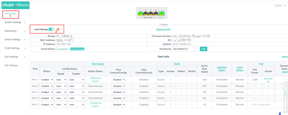

3. Configuration procedure:
Enabling vlan setting

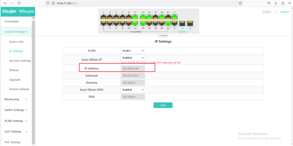

4. Final result
ES Switch can obtain an IP address automatically.
