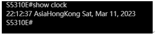

First check the time of Switch
Ruijie#show clock
Configuration Steps

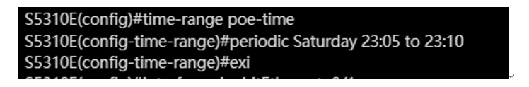

1. Set time range
Ruijie#configure terminal
Ruijie(config)#time-range poe-time

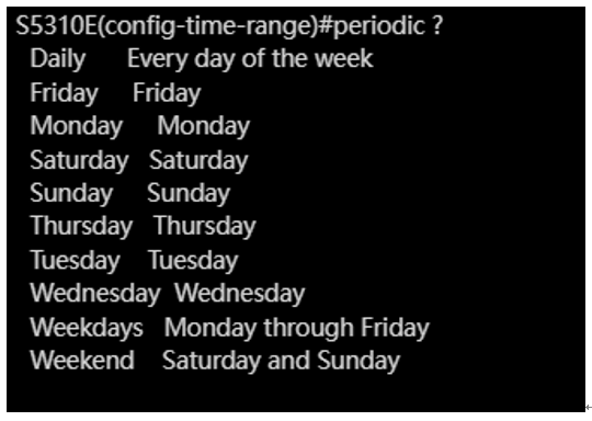

Ruijie(config-time-range)#periodic Saturday 23:05to 23:10
(you can also choose other choice according to your needs)
Ruijie(config-time-range)#exit

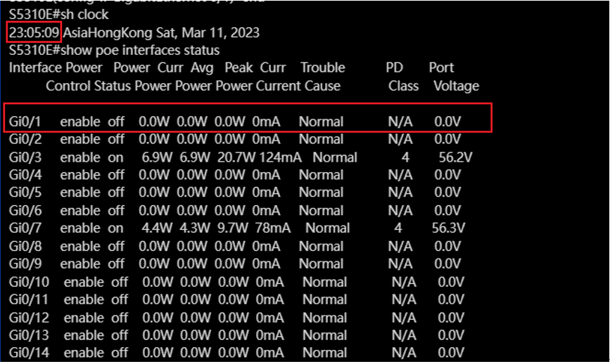

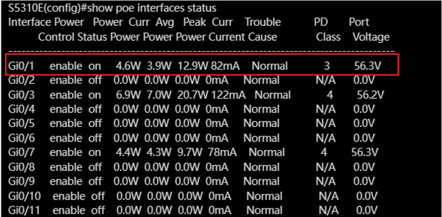

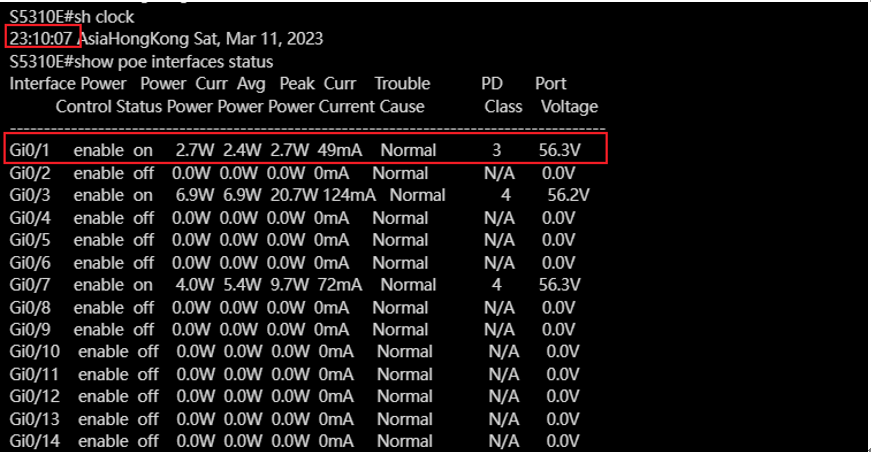

Verification
Before:
After:
When the time after 23:10
