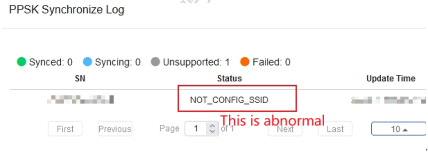

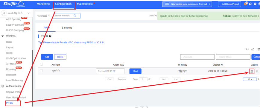

c). Check the synchronization status of the PPSK codes on Ruijie Cloud.
1). Login to Ruijie Cloud, enter the PPSK page via this path: [Configuration]> [PPSK]
2). Choose the faulty PPSK code, click on the view button, and check the PPSK synchronization log.

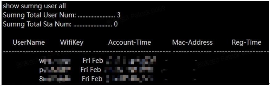

d). If the PPSK Synchronize log is abnormal, check the PPSK record on Ruijie AP.
You can use this command to check it out: show sumng user all

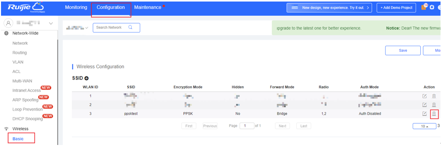

e).If the faulty PPSK code does not appear on the show sumng user all
result, you can try to delete the SSID with PPSK authentication, then re-create it.
