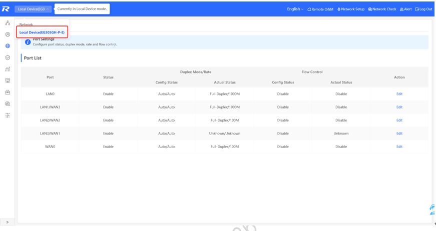

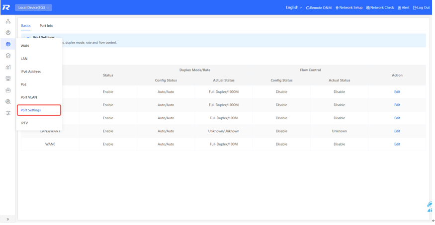

You can configure it according to the following steps
1.Enter EG's web interface
2. Click ‘Port Setting’

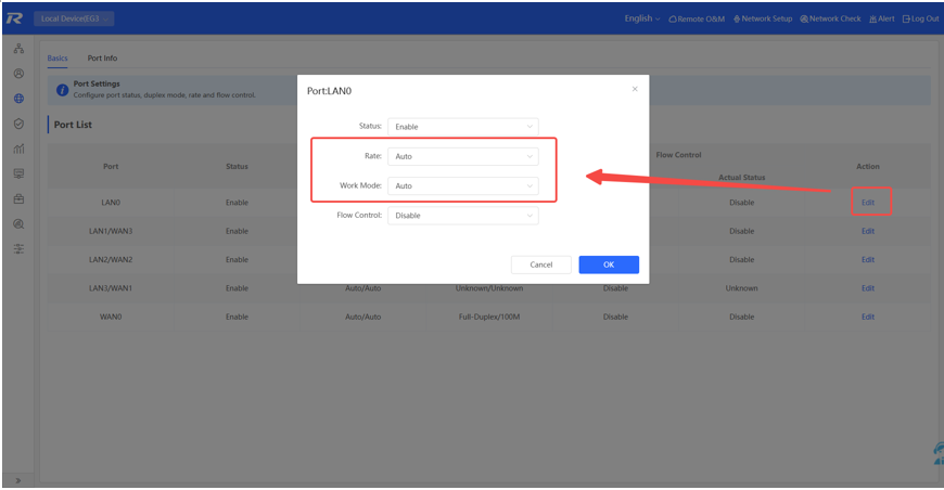

3.Select the port to be configured and click 'Edit '
RG-EG105G V2
