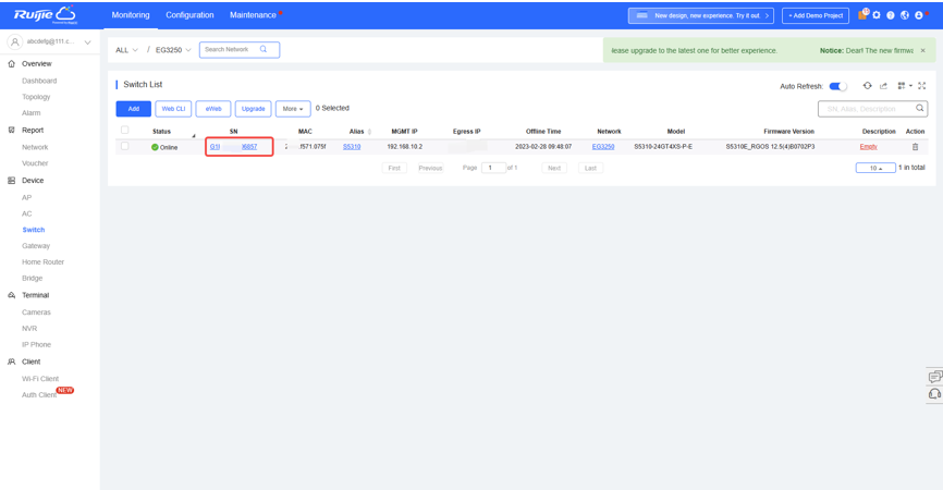

You can configure it according to the following steps
1. Select switch
2. Click Diagnose

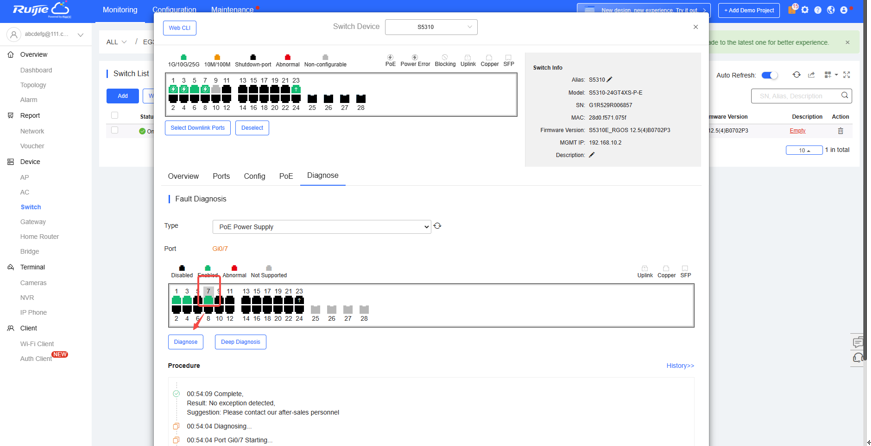

3.Select the port to be diagnosed and click 'Diagnosis'.
