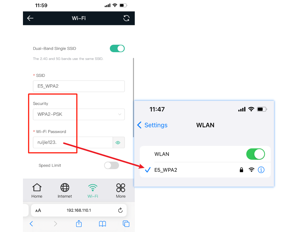

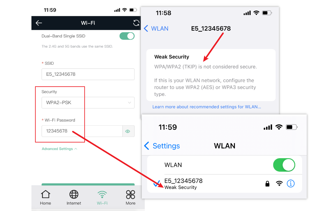

You can change the password to a more complex one and test again.
It may be because of the trust certificate of the iPhone.
Please check my test results below:

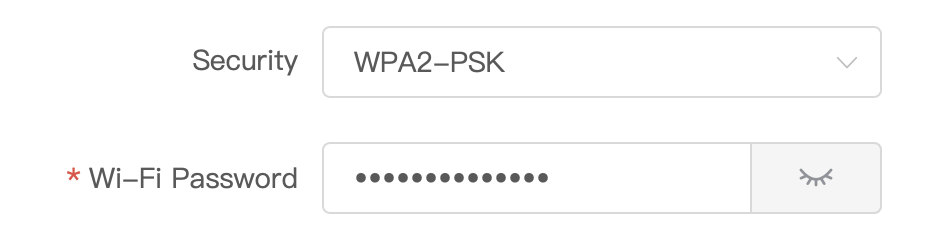

Sure this is the EW1200G-PRO configuration:

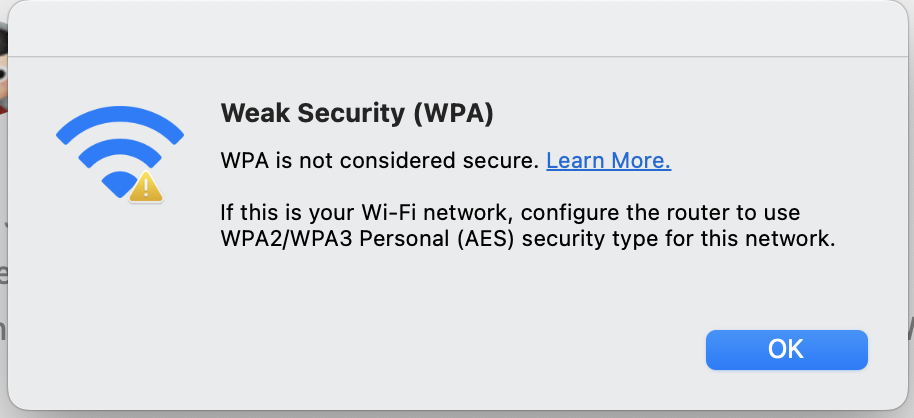

And this is the Mac error:
