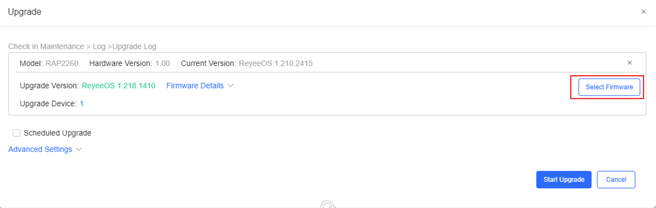

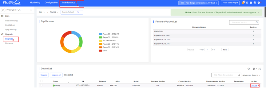

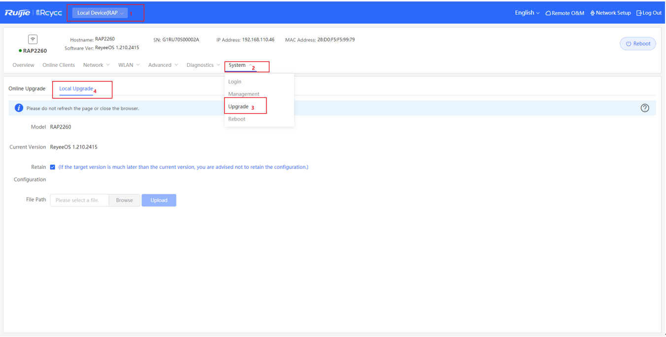

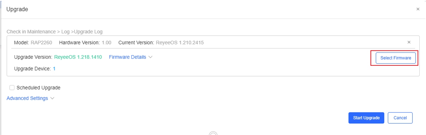

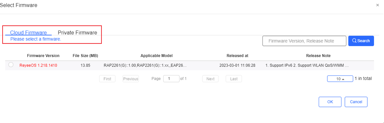

You can upgrade or degrade the firmware of Reyee AP as follows:
(1) On cloud
(2) On the local web (Take RAP2260 as an example)
Note: You can download the required firmware version from the official website.
