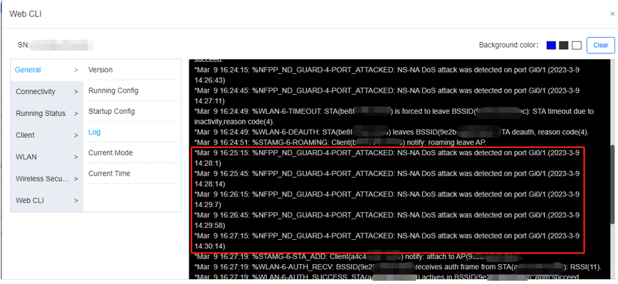

Fault phenomenon
Problem description:
It takes some minutes for a newly connected user to connect to AP. After checking logs and find there are a lot of dos attacks logon AP. The more users connected to AP, the more logs there are.
Requirements:
After functions such as arp-guard and ip-guard are enabled in NFPP, log information is printed according to the corresponding configuration. If certain attacks are received, users may be unable to access the Internet. Therefore, you can disable the nfpp protection mechanism.

After disable it and clear nfpp logs, there are no more NFPP logs on device and user can access internet as normal.
