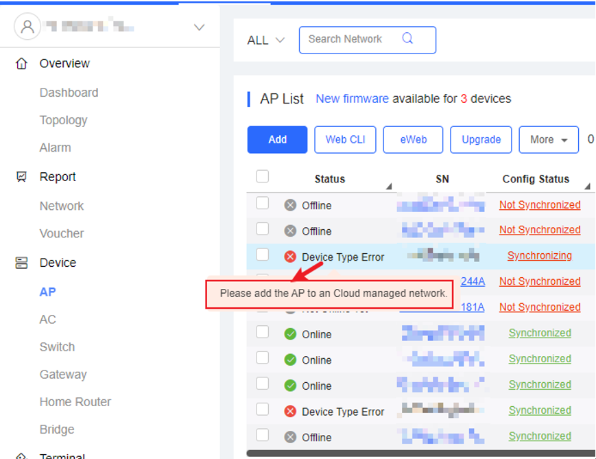

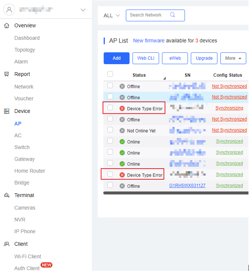

You can perform the following steps to troubleshoot the Device type error on Cloud:
1. Problem description:
2. Troubleshooting steps:

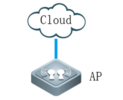

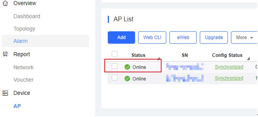

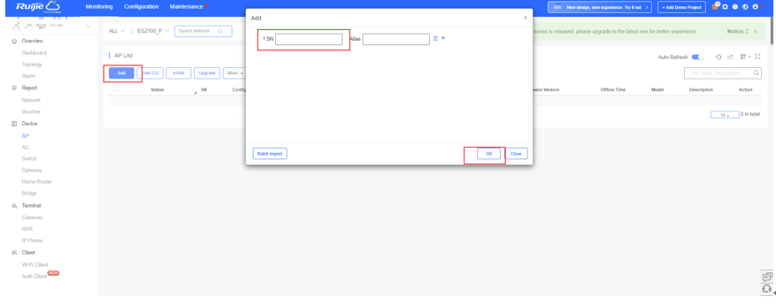

(1)For Cloud+AP mode:

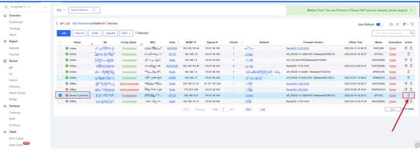

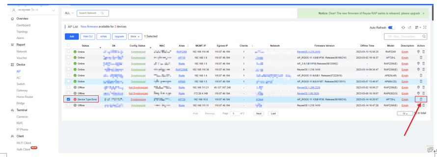

1) Delete AP
2) Add the AP to current project

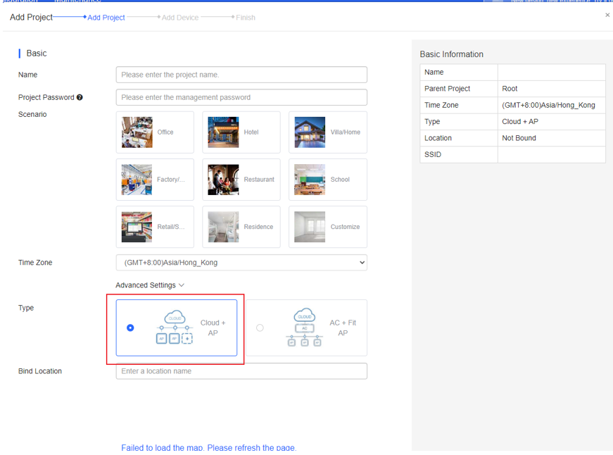

3) AP online on the project
4) The reason is that the project was not created in Cloud+AP mode

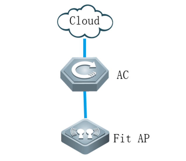

(2) For AC+Fit AP mode:
1) Delete AP
2)The reason for this issue was that customers added this AP SN into the AC list as follows:
Troubleshooting Cloud
