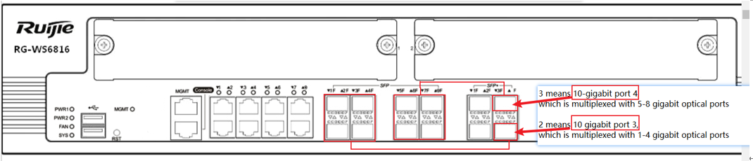

After 11.1(5)B9
version:
Ruijie(config)#tenGigabitEthernet 0/3 enable   --->Enable the 10-gigabit port
Ruijie(config)#no tenGigabitEthernet 0/3enable  --->Change it to the gigabitport back(gigabit por is by defult)
Ruijie(config)#end
Ruijie#write  ---> save the configure
Ruijie#reload  ---reload device for active
Notes:After the 10-gigabit port is enabled, the gigabit port becomes unavailable
Before 11.1(5)B9
version:
Ruijie(config)#xaui-mode slot 2      --->Enable the 10-gigabit port (slot 2means 10 gigabit port 3, with 1-4 gigabit port multiplexing; slot 3 means10-gigabit port 4, which is multiplexed with 5-8 gigabit optical ports)
Ruijie(config)#no xaui-mode slot 2      --->Change it to the gigabit portback(gigabit por is by defult)
Ruijie(config)#end
Notes: After the 10-gigabit port is enabled, the gigabit port becomes unavailable
