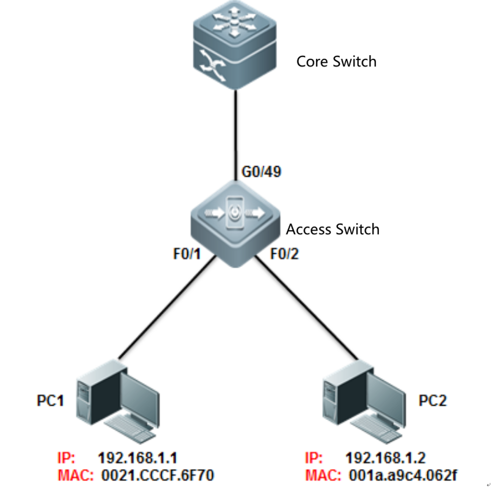

Requirement:
1.
PC1(IP: 192.168.1.1,MAC: 0021.CCCF.6F70)canonly connect to access switch F0/1,and configure IP+MAC binding other PC conenct to this port cannot be accessed when connected to this port;
2. F0/2port can only allow ip address 192.168.1.2 access to the internet, MAC address is not limited other ip address cannot access internet when connected to this port.
Topology:
Configuration tips:
On ports F0/1 and F0/2, you need to enable switchport port-security and limit MAC address binding entries to 1
Configuration Steps:

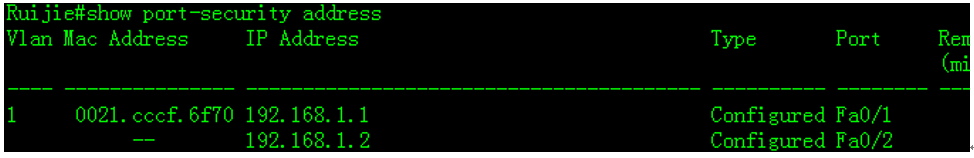

Verification:
Ruijie#show port-security address
