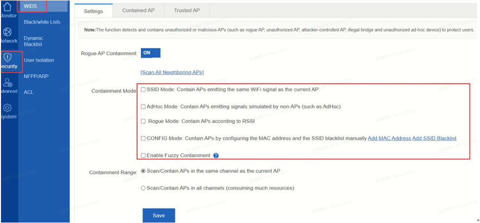

How to enable Counter AP on Ruijie AP on Web interface? Reply
3459 0 2023-7-11 17:44:10
Choose [Security]-->[WIDS],then you can enable Rogue AP.
You can choose different Containment Mode toprevent other devices from abusing your network.

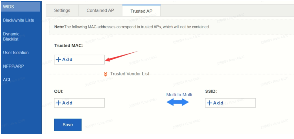

And you can also choose the trusted AP's MAC address in the list.
