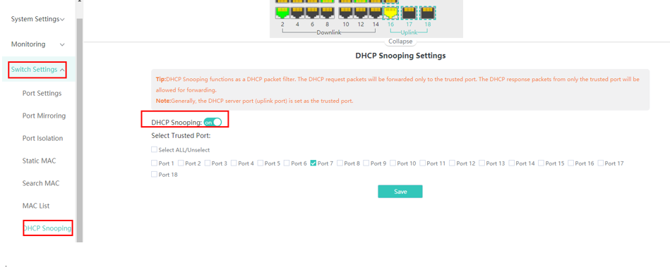

Choose [SwitchSettings]> [DHCP SnoopingSettings]
Toggle the switch to onto enable DHCP snooping,select the trusted ports, and then click Save. When DHCP snooping is enabled,request packets from DHCP clients are forwarded only to trusted ports. Forresponse packets from DHCP servers, only those from the trusted ports areforwarded.
Note: The uplink port connected to the DHCP server is configured as the trusted port generally.
