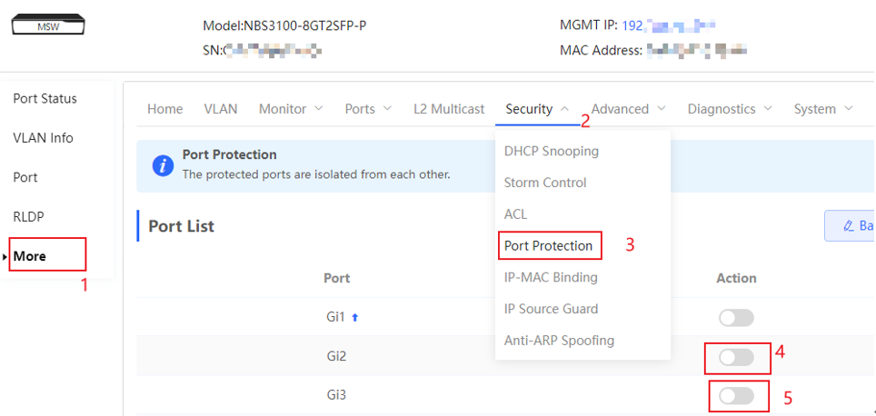

You can configure port protection on Reyee NBSswitch via this eweb path:
[More]> [Security] > [Port Protection]
After that, you can choose the port you want to configure, and turn on the Action button.
Notice:
Ports that enable port protection (protected ports) cannot communicate with each other. Users on different ports are Layer2-isolated.
The protected ports can communicate with non-protected ports.
