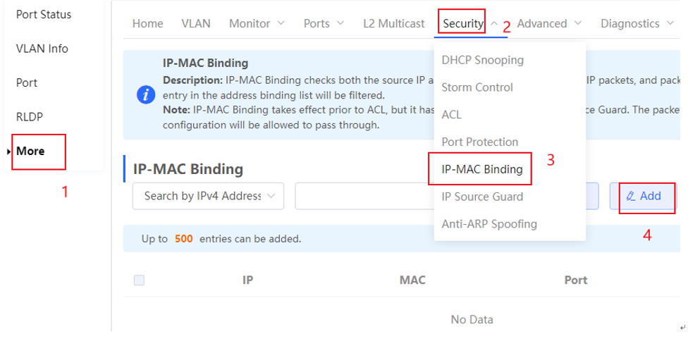

You can configure IP-MAC Binding on Reyee NBS switch via this eweb path: [More]> [Security] > [IP-MAC Binding]

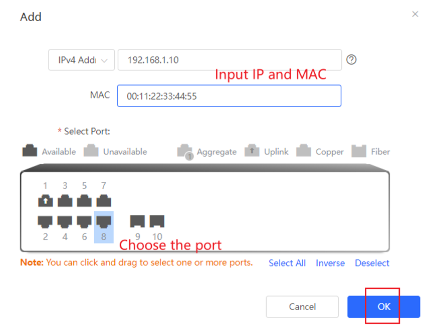

After that, you can click on the Add button, and add the IP&MAC binding relation on it.
When an IP-MAC binding is configured on a port, the device will check whether the source IP and source MAC of IP packets are those configured for the device, filters out IP packets not matching the binding, and strictly control the validity of input sources.
