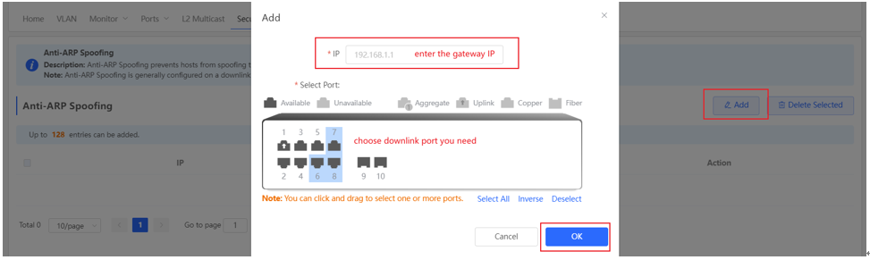

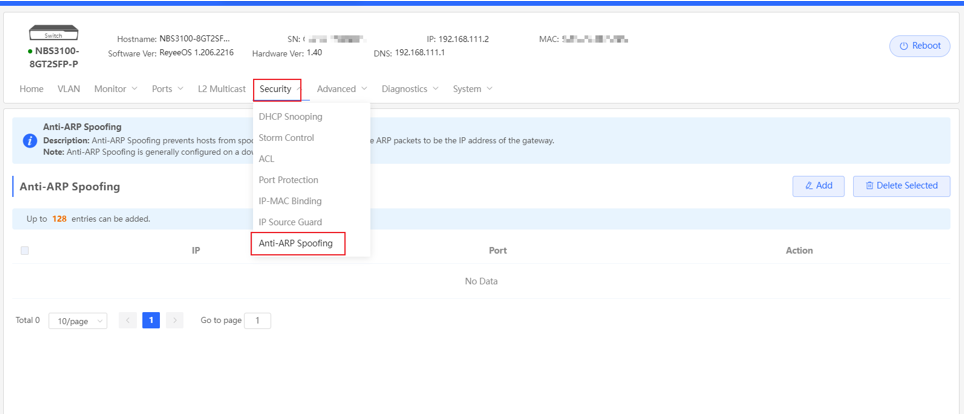

Description:Gateway-targeted ARPspoofing prevention is used to check whether the source IP address of an ARPpacket through an access port is set to the gateway IP address. If yes, thepacket will be discarded to prevent hosts from receiving wrong ARP responsepackets. If not, the packet will not be handled. In this way, only the uplinkdevices can send ARP packets, and the ARP response packets sent from otherclients which pass for the gateway are filtered out.
Note: Anti-ARP Spoofing is generally configured on a downlink port.
