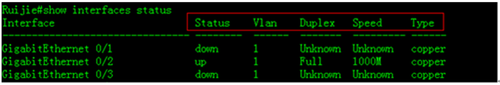

Confirmation command:
Ruijie#show interfaces status
