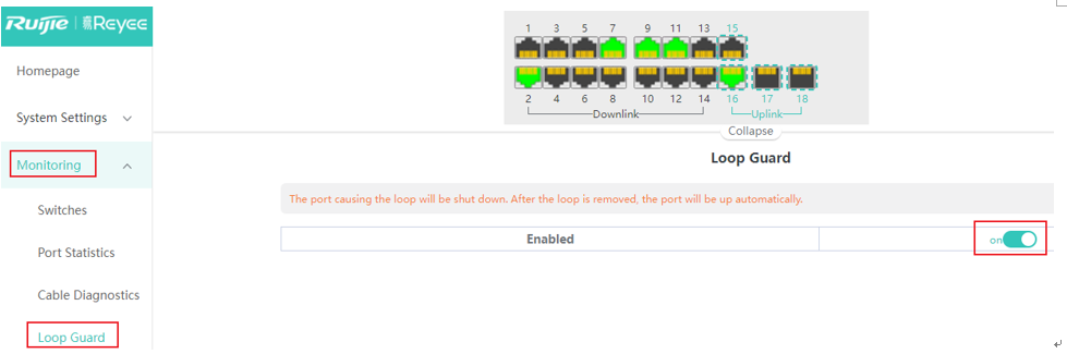

Reyee ES200 series switch supports Loop Guard.
You can simply enable this function on the eweb of Reyee ES200 series switch, then the port causing the loop will be shut down.
