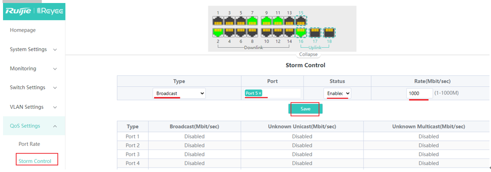

You can configure storm control on Reyee ES200 series switch by following these steps:
1.Login to the eweb of Reyee ES200 series switch, enter this path:
[QoS Setting]> [Storm Control]
2.Select the storm control type, port, status, and enter the rate limit, and then click Save.
Notes:
The rate limit for the ports of RG-ES226GC-P,RG-ES218GC-P, RG-ES205GC-P, RG-ES209GC-P switches ranges from 1Mbps to1000Mbps.
