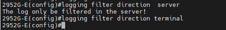

Ruijie(config)#logging filter direction server
    Ruijie(config)# logging filter direction termianl

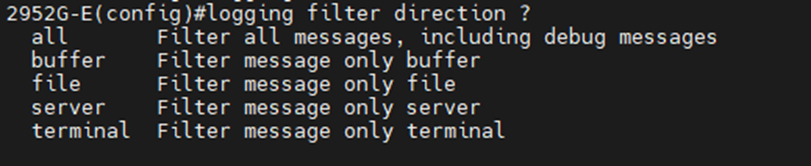

all: Filter loginformation in all directions, including the Console direction, VTY terminal,log buffer, log file, and log server
buffer: Filter thelog information of the past log buffer
file: Filter loginformation for past log files
server: Filter thelog information of the previous log server.
terminal: Filter logs to the console and VTY terminals (including Telnet and SSH)

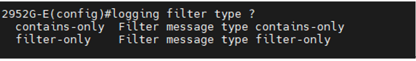

2. logging filter type filter-only
Contains-only:Indicates that only logs that contain the keyword information in the filteringrules are output. Logs that do not contain keyword information in the filtering rules are not output.
filter-only: that logs that contain keywords in the filtering rules are filtered out. The filtered logs are not displayed

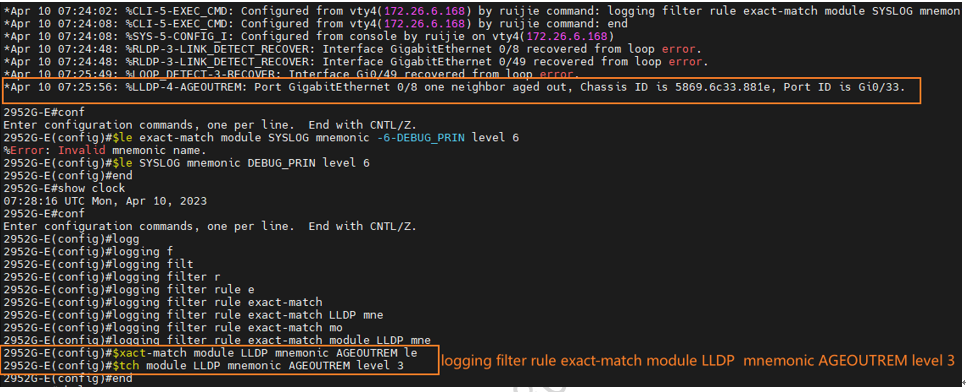

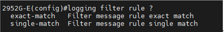

3. logging filter rule { exact-match module module-name mnemonic mnemonic-name level inform-
level }
logging filter rule single-match { level inform-level |mnemonic mnemonic-name | module module-name }
Exact-match: match the exact information
mnemonic mnemonic-name: The mnemonic name of the log information to be filtered.
level inform-level: Level of log information to be filtered. The ranges from 0 to 7.
module module-name: Name of the module to be filtered.
Single-match: match the single information

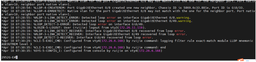

Exact-metch: filter the log"  %LLDP-4-AGEOUTREM: Port Gigabit Ethernet 0/8one neighbor aged out, Chassis ID is 5869.6c33.881e, Port ID is Gi0/33."
